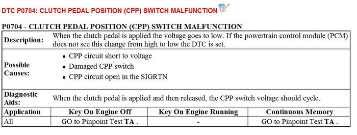

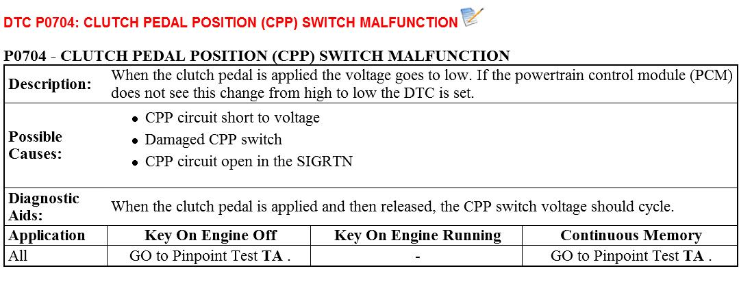

Finally had scan and the code is po704. Now this is a sensor, what does it do, where is located, and what would be the cost?
Saturday, October 24th, 2020 AT 11:19 AM (Merged)
KHLOW2008
  • 41,815 POSTS
This code is not correct. Yours is an automatic trnsmission and this code is for a manual transmission clutch pedal position switch.
DCRIDER
  • 11 POSTS
Sorry had my glasses off it is 705
