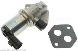

MERLIN2021
  • 17,250 POSTS
First, is the MIL(check engine) light on? And if not, check the IAC(idle air control, it's bolted to the side of the throttlebody.
https://www.2carpros.com/forum/automotive_pictures/62217_Ford_IAC_Wgasket_1.jpg
Friday, October 9th, 2020 AT 12:53 PM (Merged)
