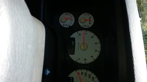

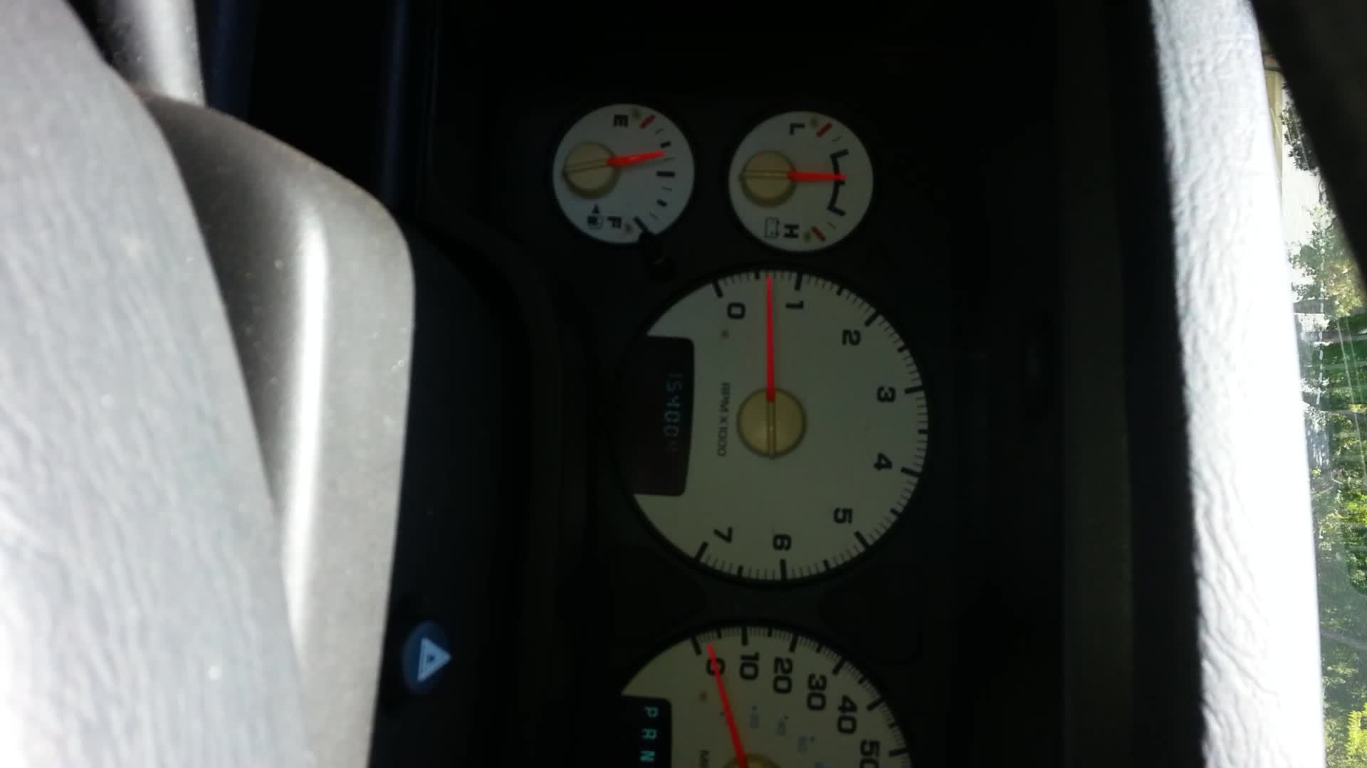

Thanks for the video. We should run the codes also does it have the catalytic converter still on it? Sounds like you have an exhaust system maybe?
Lets do this guide next.
Friday, August 9th, 2019 AT 12:36 PM
WAIN ZAIN
  • 5 POSTS
No lights have ever come on. But I took it to O'Reillys anyways thinking that maybe the bulb was out on my check engine light. But I was told no light, no codes, no information.
