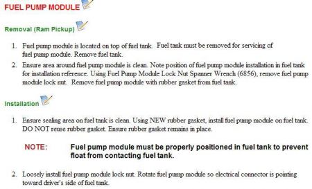

how to change the fuel pump on a 2002 quad cad truck

Diesel or gasoline engine?
Wednesday, September 2nd, 2009 AT 7:31 PM
GEEWHIZ88
MEMBER
2 POSTS
Gas
Wednesday, September 2nd, 2009 AT 7:33 PM
BLUELIGHTNIN6
MECHANIC
16,542 POSTS
Wednesday, September 2nd, 2009 AT 7:58 PM
