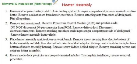

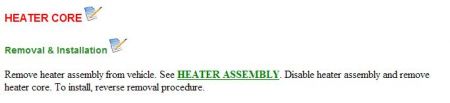

how do you replace a heater core on a 2000 dodge ram 1500 with air conditioning
