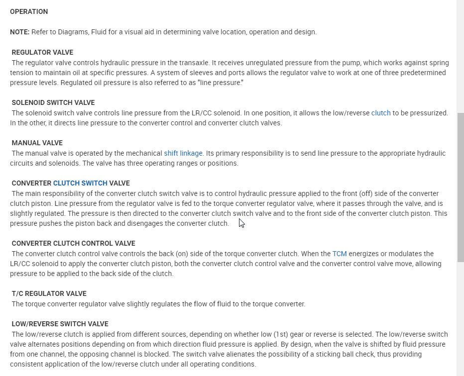

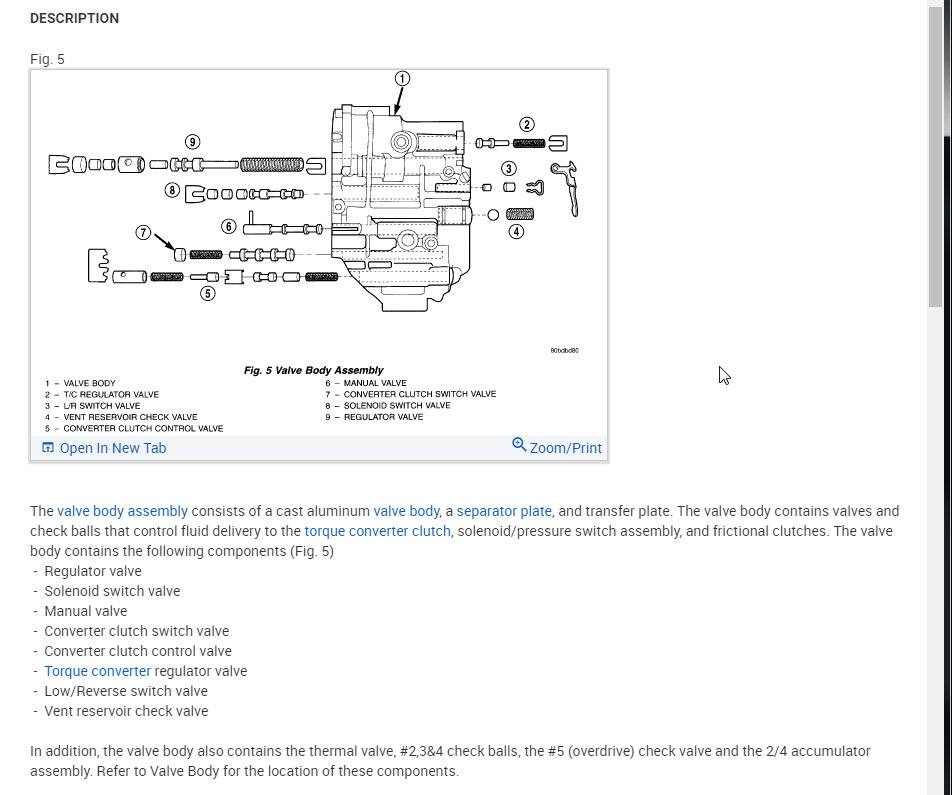

Have you checked for codes? I suspect we have a valve body issue but since it is in low gear it should have some codes that will tell us what the issue is.
If you can't pull codes, then most parts stores will pull them free of charge.
Let's start with the codes because you have replaced the most common causes which is the speed sensor and fluid.
