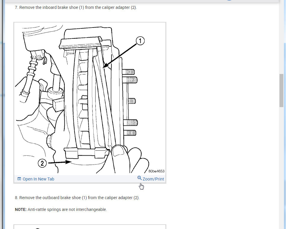

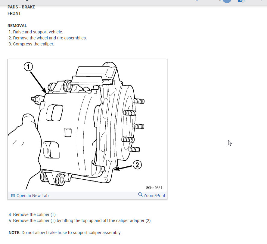

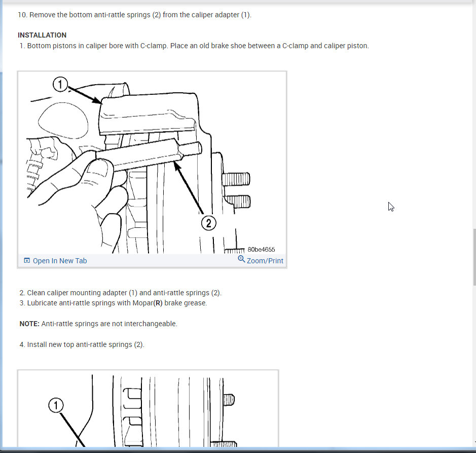

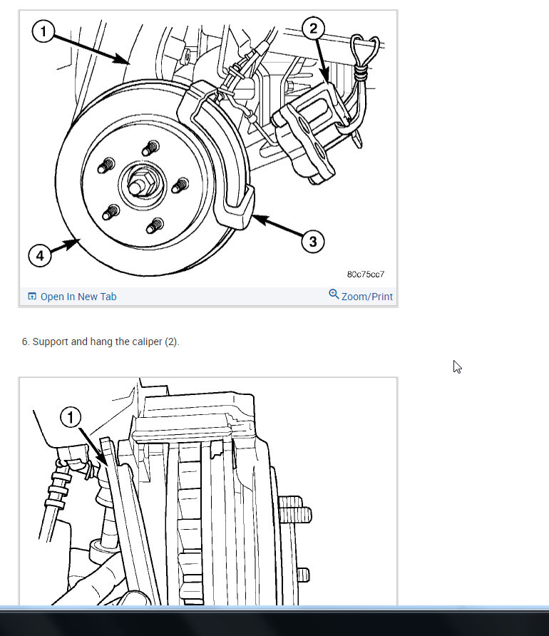

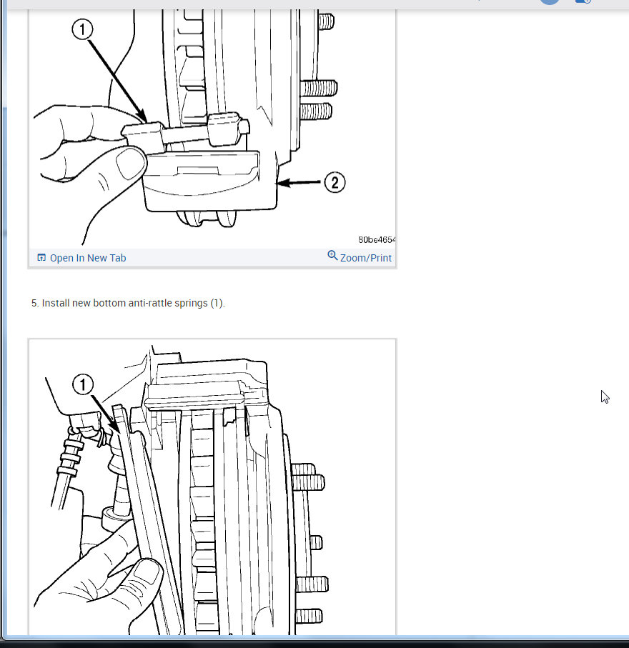

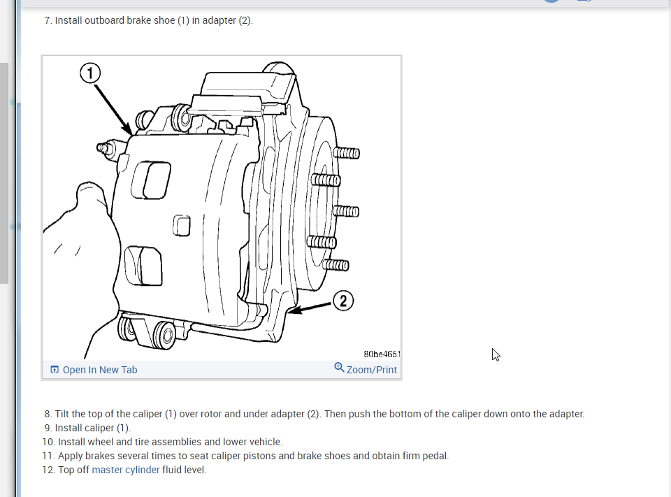

Why would the brake grind a friend said I need brake but I want to them myself.

Below is the process from the manual on how to replace the pads. let us know if you have questions. Thanks
