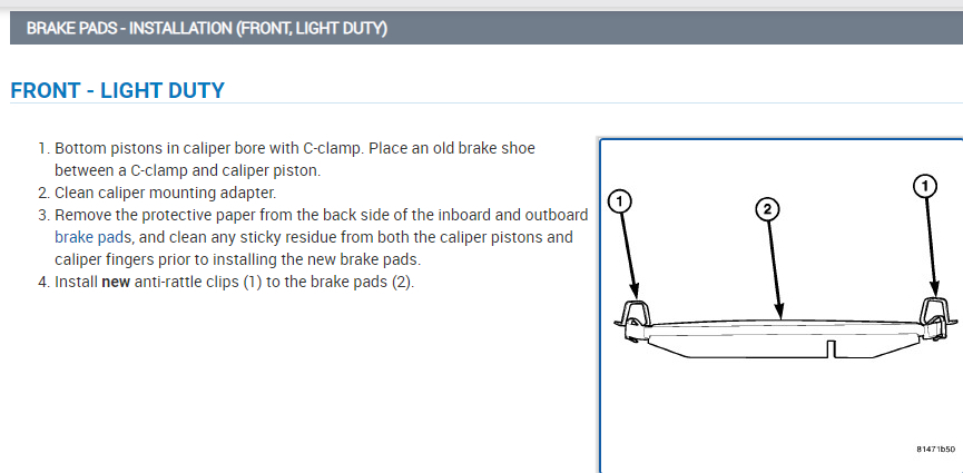

Front brake grabs or locks up in gravel or wet asphalt at low speeds I think I need front pads

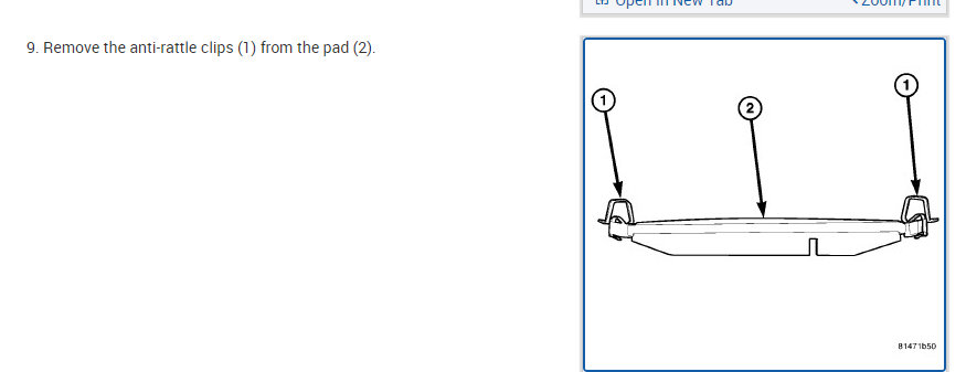

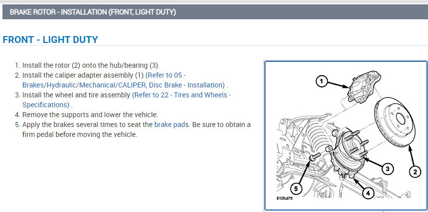

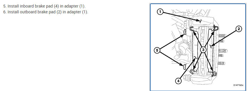

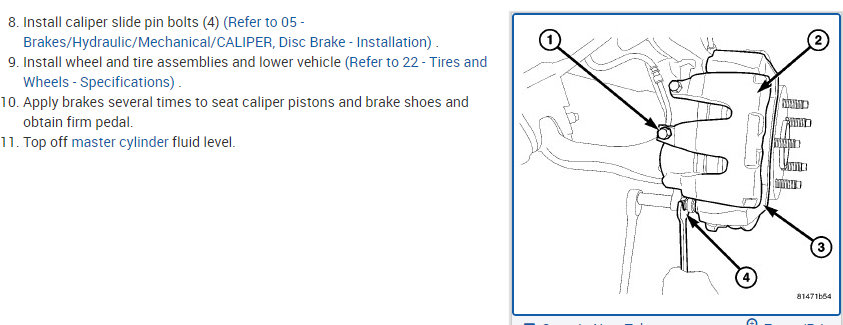

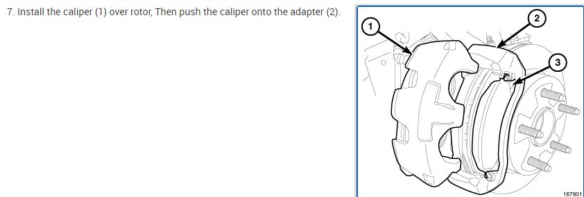

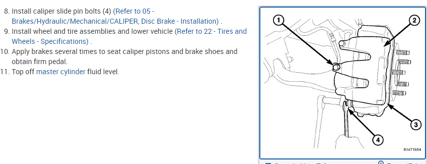

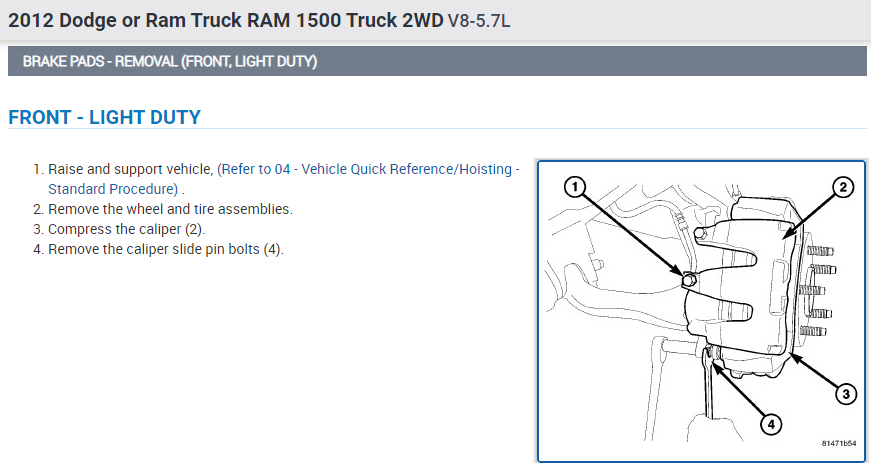

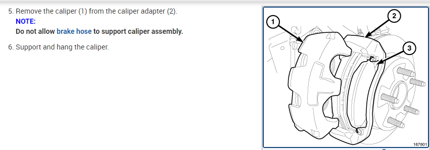

Hello, I'm Danny.

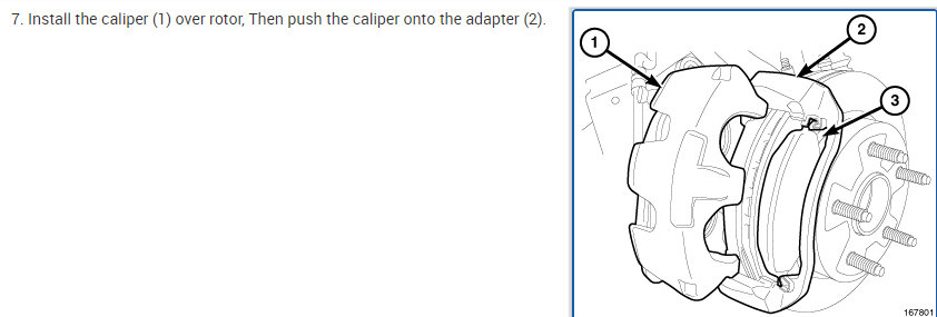

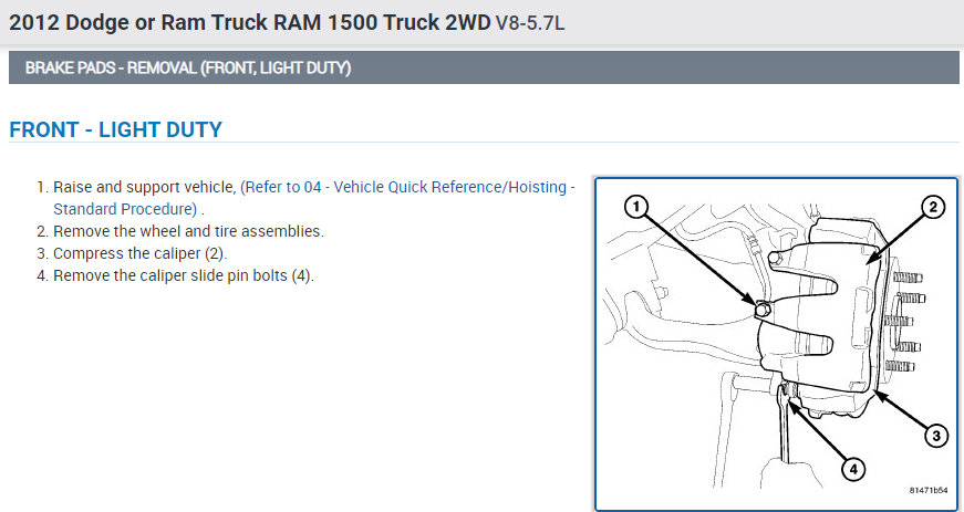

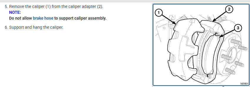

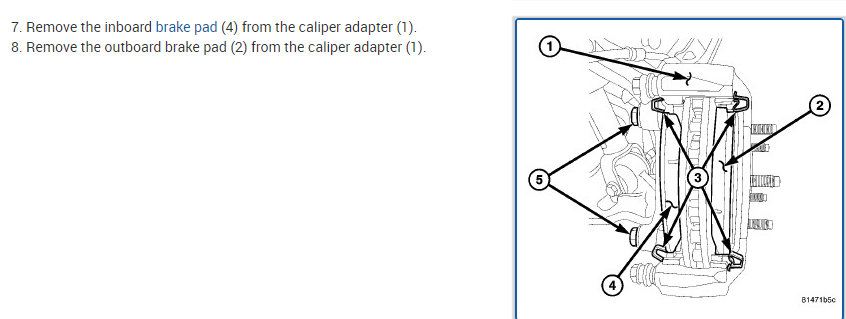

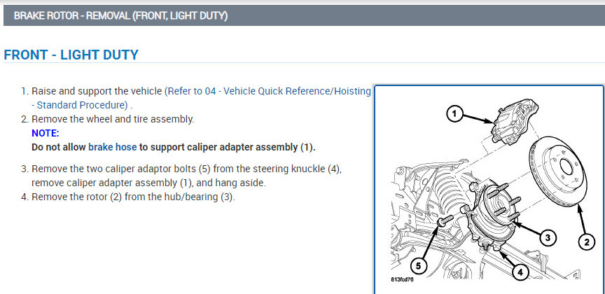

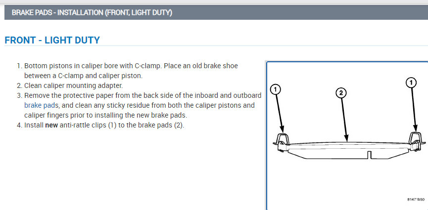

Here is the information you requested. This is a tutorial showing what is involved on how to change front brake pads and brake rotors with instructions below for your truck.
I've attached picture steps below on how to change the front brake pads and rotors on your truck. Hope this helps and thanks for using 2CarPros.
