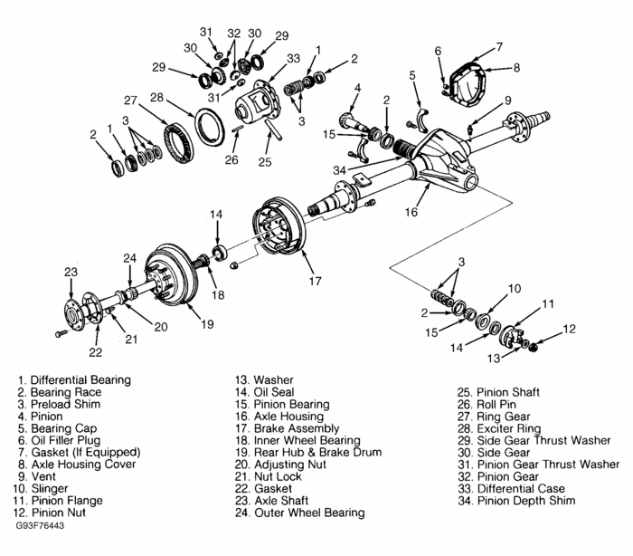

I hear strange noise from the differential went driving need replace oil or are not what to do I don't have to much money to take to dealer what you recommend to do?

What kind of noise? Banning? Whine? Grind? First step is to remove the cover, put a catch pail under it, Insect for metal on the magnet, a lot means trouble, small amounts are not bad.

First things to check when you get a noise in the drivetrain, are the U-Joints, they are the weakest link.

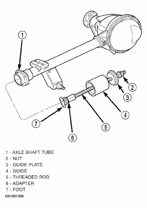

Need to replace right rear outer bearing?

This repair is the same differential as a Chevy pretty much, here is a video that will show you how
https://youtu.be/zarxKsspr3s
AXLE BEARINGS
REMOVAL
Place transmission in neutral.
Raise and support the vehicle.
Remove wheel and tire assembly.
Remove brake caliper, adapter and rotor.
Remove axle shaft.
NOTE:The seal and bearing can be removed at the same time with the bearing removal tool.
Remove axle shaft seal from axle tube with a small pry bar.
Remove axle shaft bearing with Bearing Remover 6310 and Foot 6310-9

How hard is it to replace rear Axle Bearings on a 1996 1500 4x4 Dodge Ram Truck? Thank you

Remove wheel unbolt axle remove axle then lock nut for outer wheel bearing if need inner remove drum oil seal and inner bearing. Well need bearing puller
