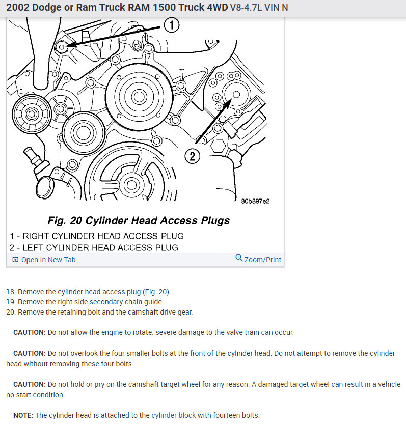

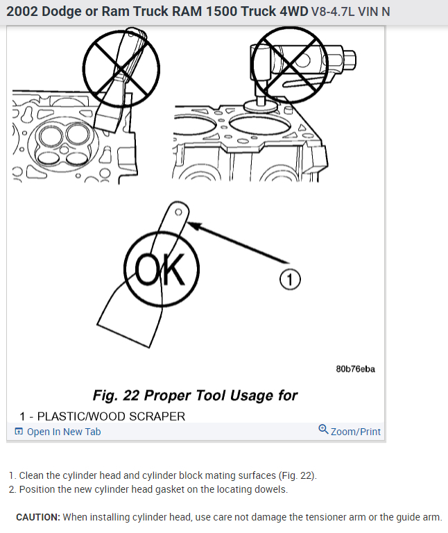

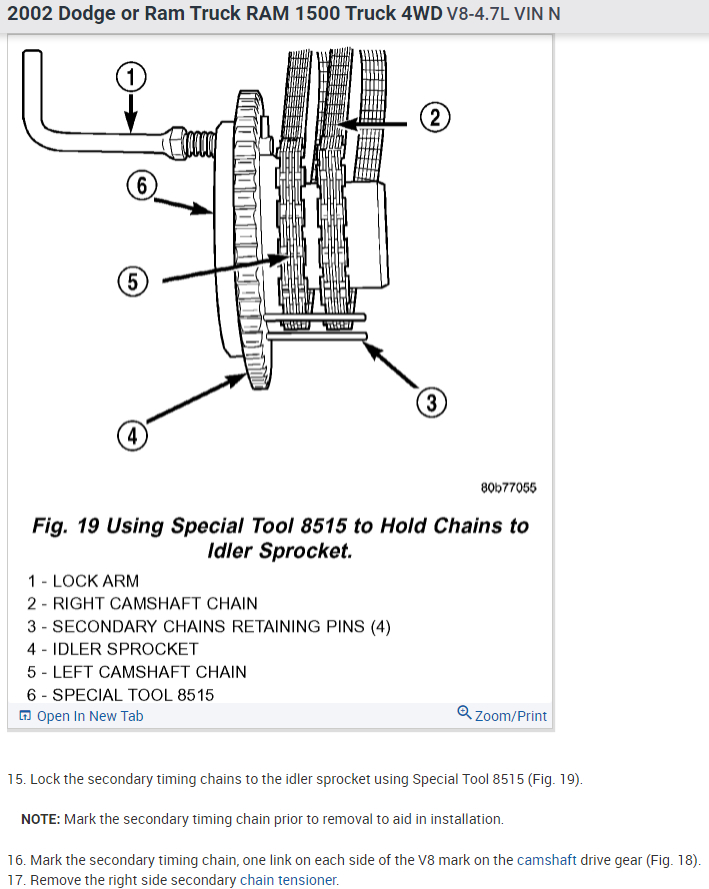

Truck ran hot and shut down. Replaced bottom hose. Truck will not start. It turns over like it wants to start but will not catch.
Friday, August 14th, 2009 AT 10:14 AM
SQM
  • 6,383 POSTS

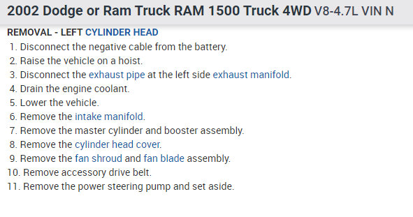

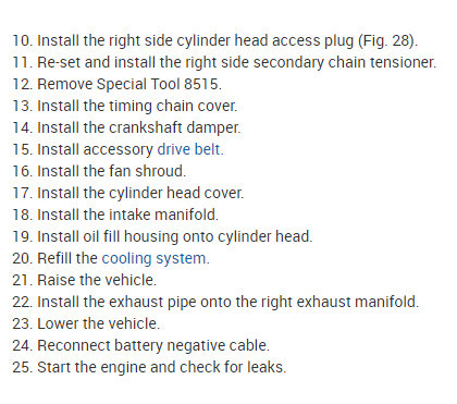

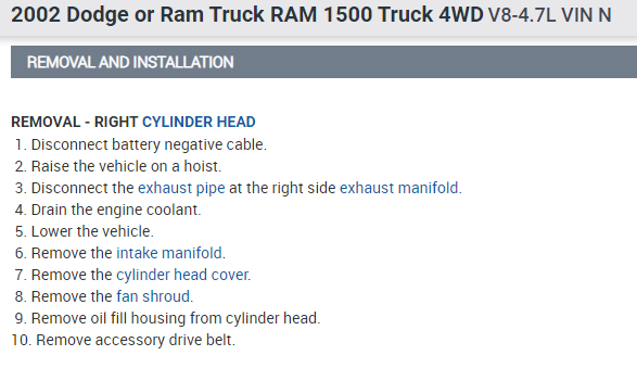

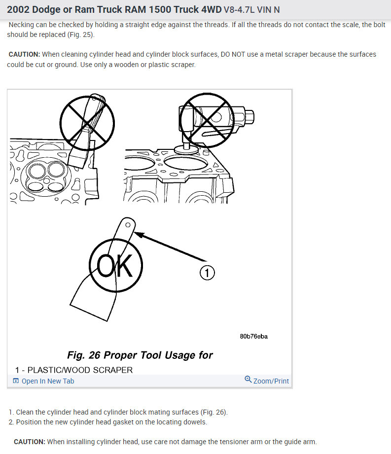

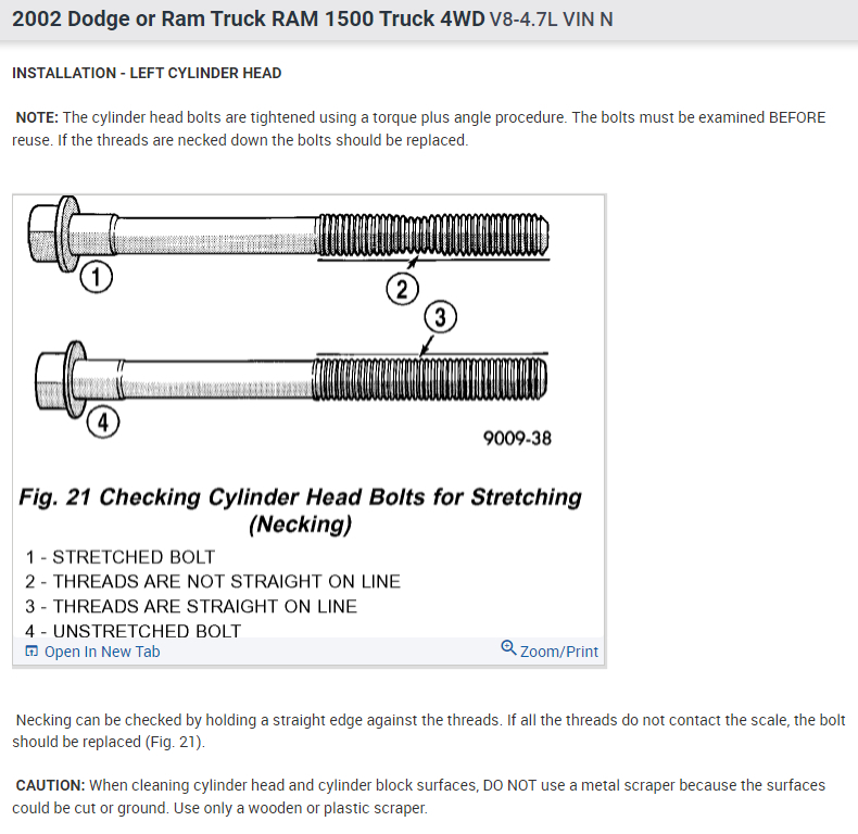

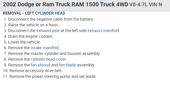

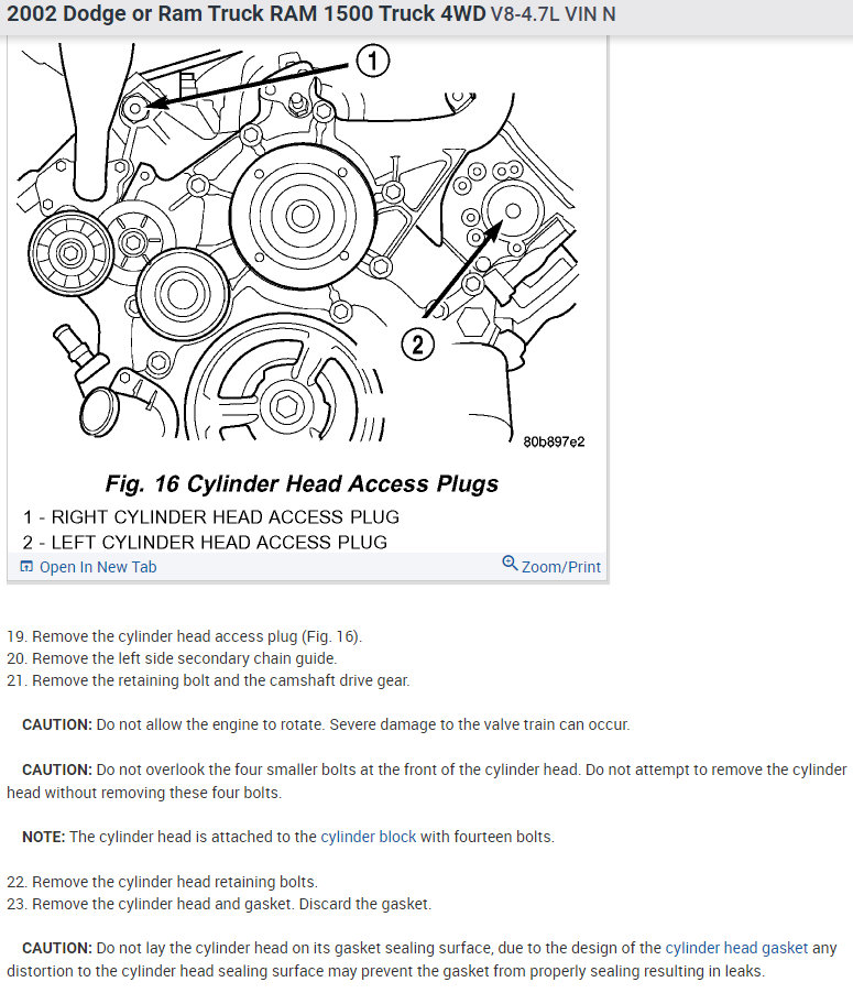

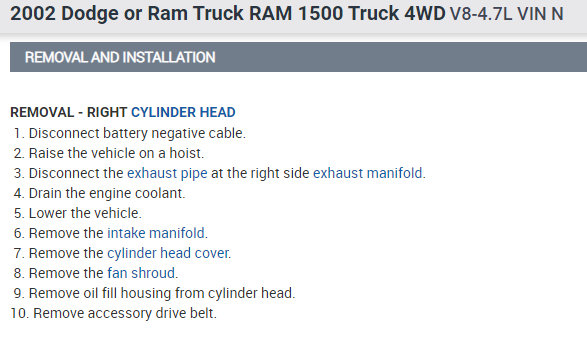

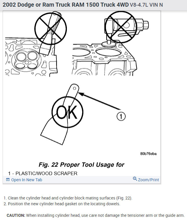

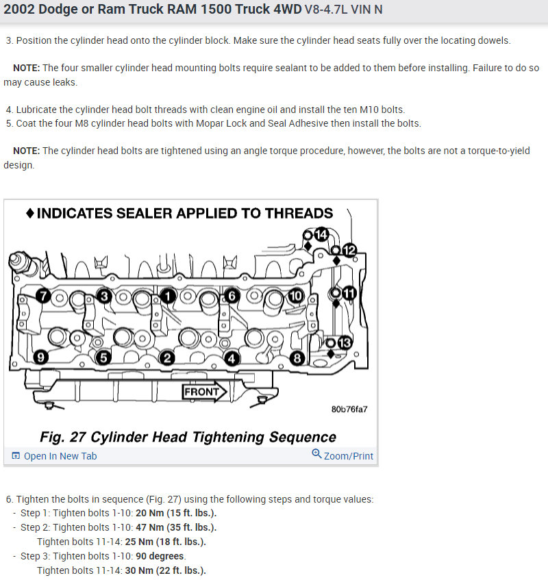

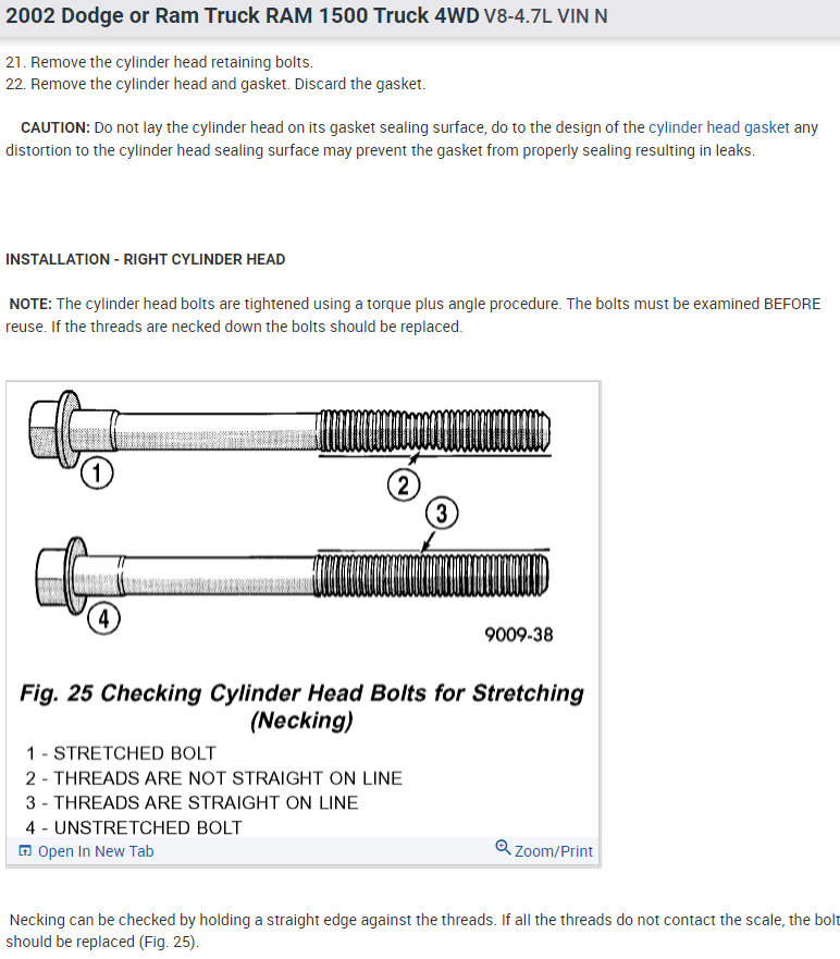

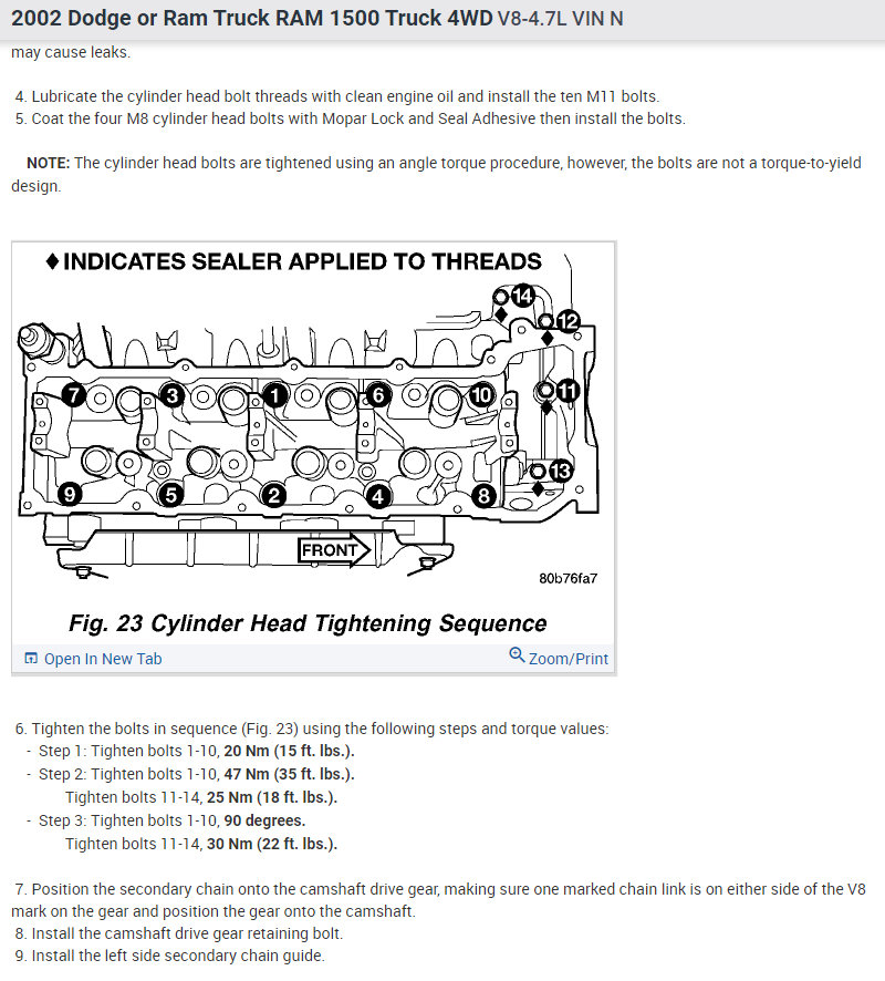

Was there an smoke coming out of the tailpipes?
When an engine overheats it can blow the head gasket. And when that happens you will have white smoke coming out of the tailpipes. This is the cause of coolant entering the engine which will burn and emit white smoke.
If the blown head gasket severe then the cylinders will be flooded with coolant and you won't be able to start the engine.
You will have to get the head gasket repaired and flush the engine before it can be driven.
