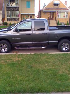

Trying to find out what would cause my Ram to overheat within a mile of driving.
I tried last night to disipate some of the heat buildup by turning on the heat and noticed there was still cool/cold air coming from the vents. After about 15 min hot air started coming out. I checked the oil when it cooled down and saw it was a quart low. Would being a quart low cause my engine to overheat that fast at low speeds or does this seem to be a thermostat issue?

EVERYAN2003
Turned out to be a hairline crack in the radiator frame. Replaced the radiator as well as the thermostat and all is good. Autozone had a direct replacement that made the swap really easy. Thanks for the response and informative website.
