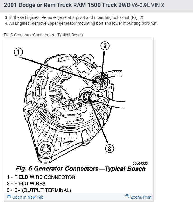

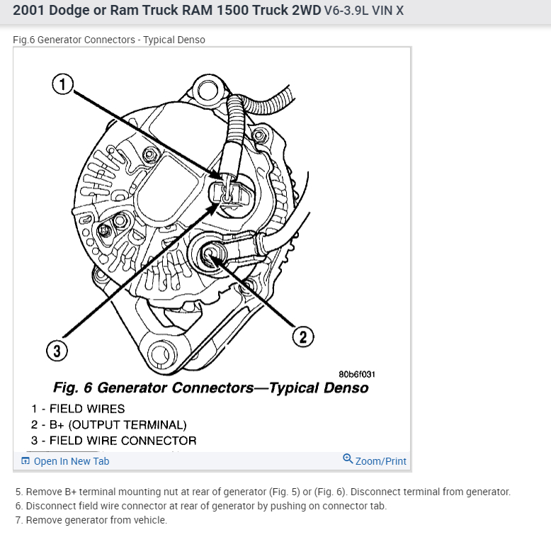

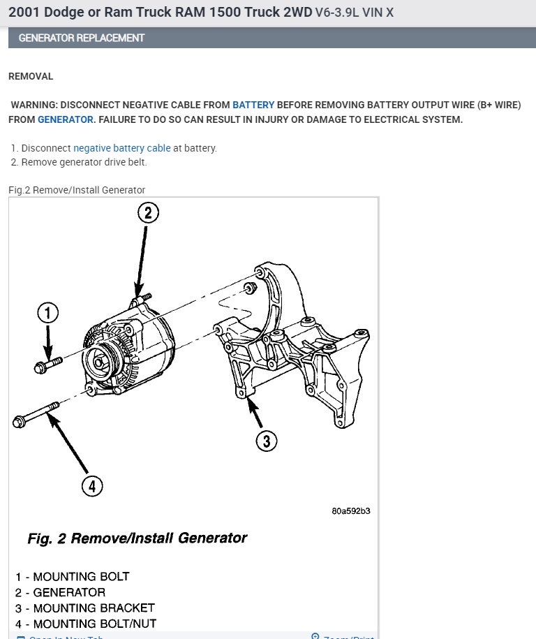

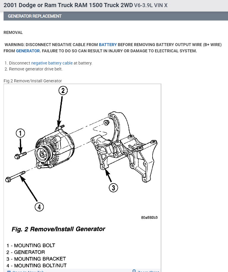

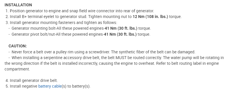

This could be due to a faulty alternator.
A good first step would be to test the alternator output. It should produce 13.6V to 15.2V to the battery.
Here is a helpful guide on how to test the alternator:

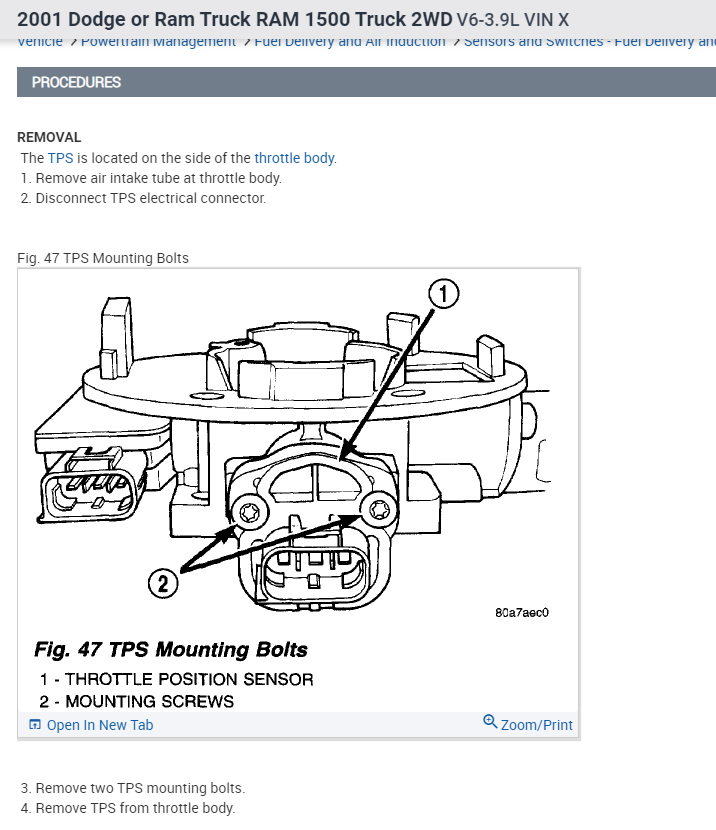

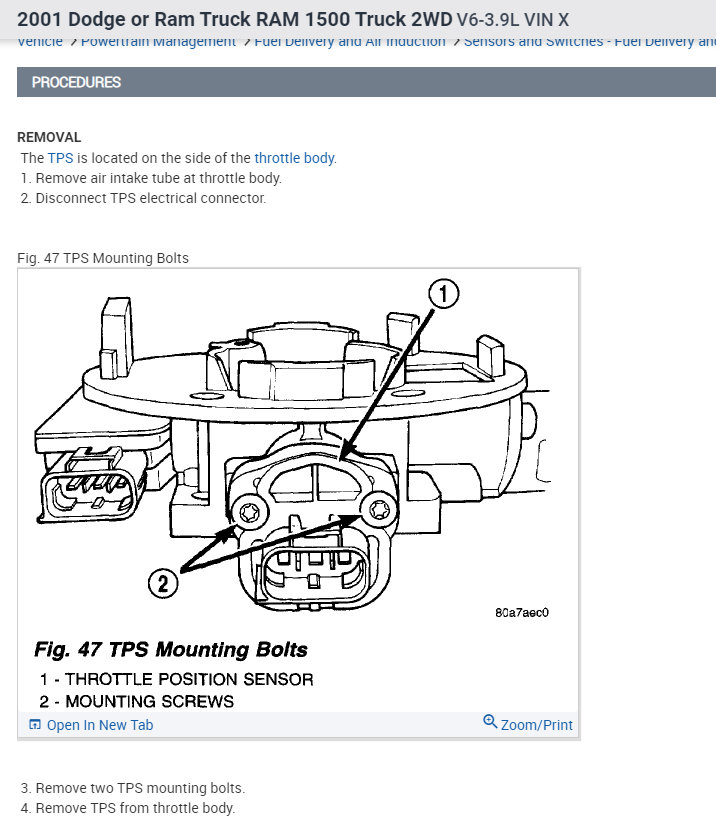

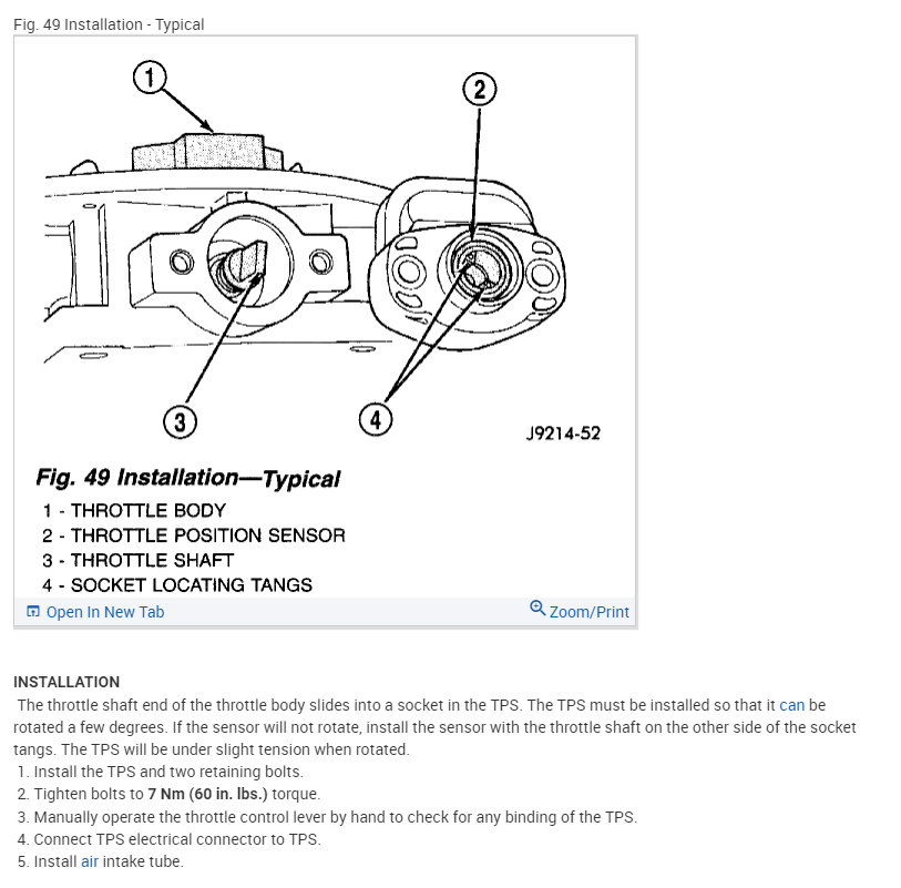

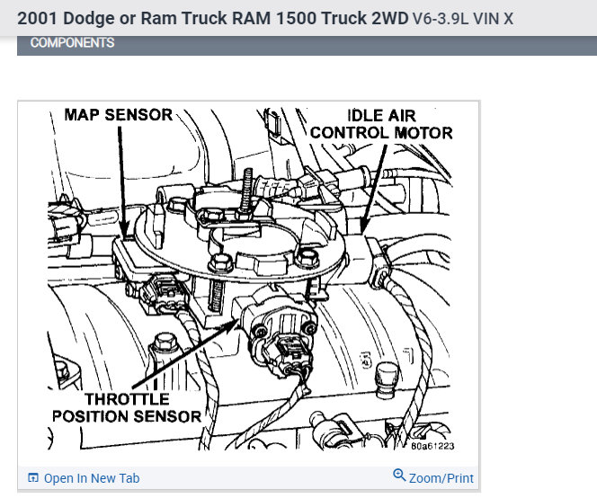

It could also be due to dirty throttle body or bad throttle position sensor.
Cleaning out the throttle body can improve drivability.
I have attached the alternator replacement procedure below.
