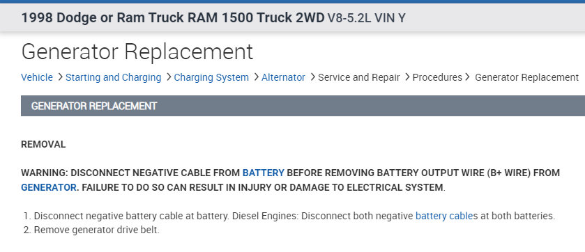

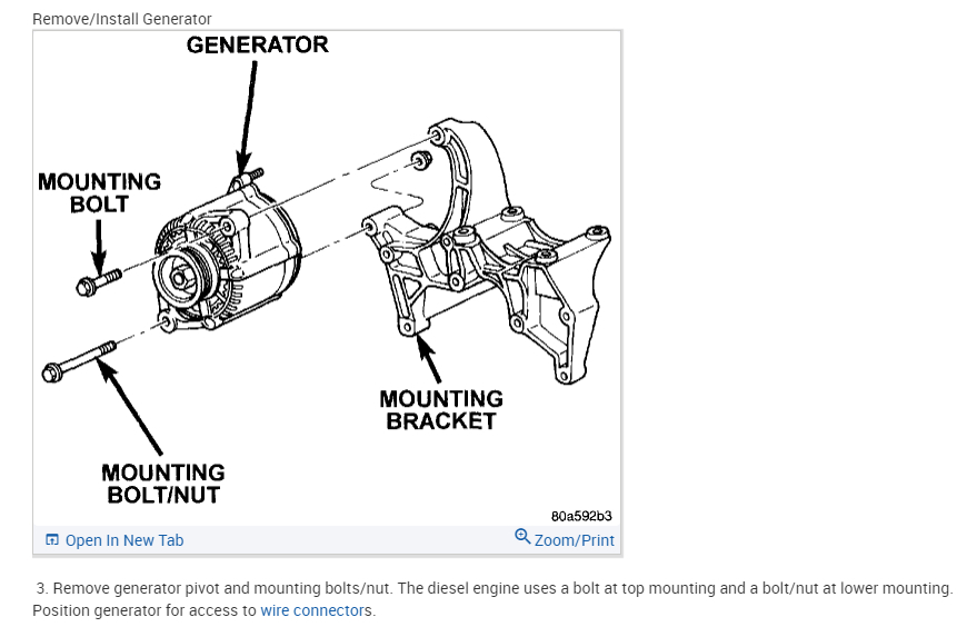

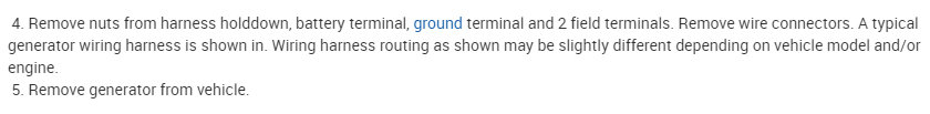

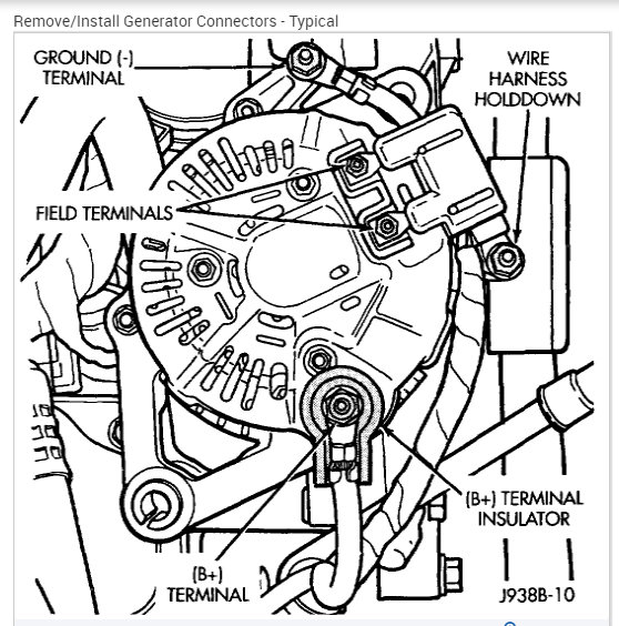

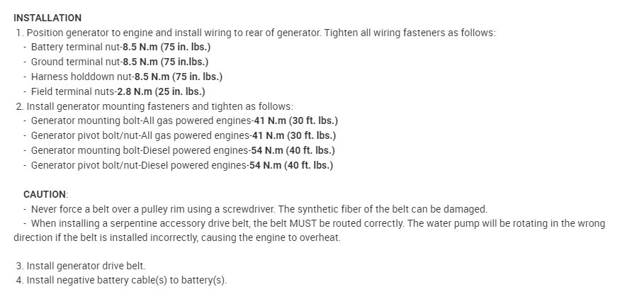

If the alternator fails the test, you will need to remove it and have it bench tested. If it fails under these conditions, replace it. If it doesn't fail, suspect the PCM has failed.
Here are directions that explain how to replace the alternator:
https://www.2carpros.com/articles/how-to-replace-an-alternator
Additionally, I attached the directions below specific to your vehicle.
