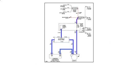

At any speed the truck will just shut down and die. When I attempt to restart, the voltage is showing to be 8 or less. After sitting a couple minutes the volts will go up to around 10 and the truck will restart. Alternator and battery have tested out fine. Up until the truck dies volts are showing to be 14. HELP.

It takes 11volts for the computer to function to control the sensors and actuators within the engine management system-sound like this charging system field winding generation is being controlled by the computer have checked out see below
https://www.2carpros.com/forum/automotive_pictures/12900_1999_dodge_ram_2.jpg
