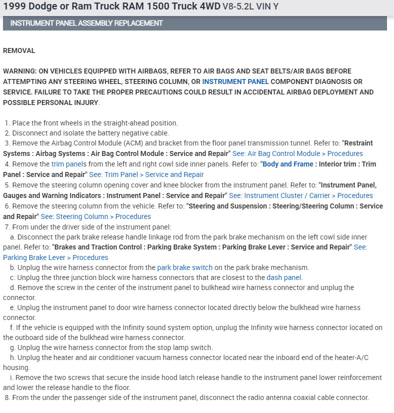

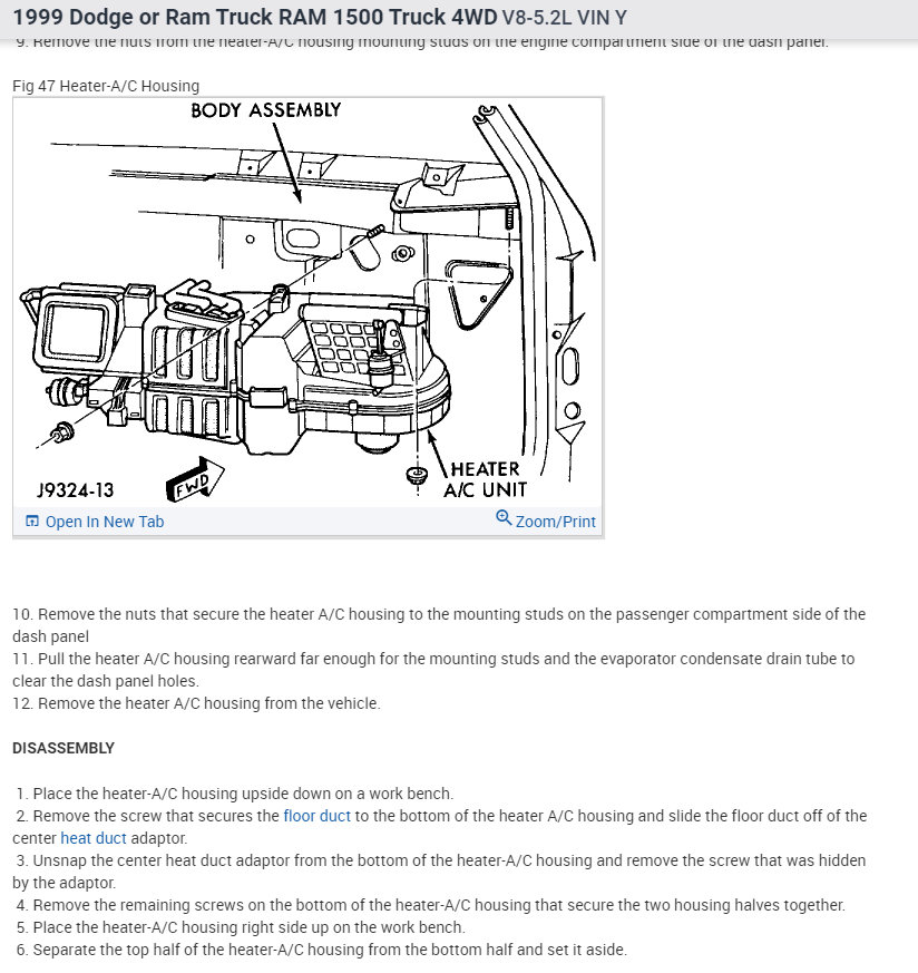

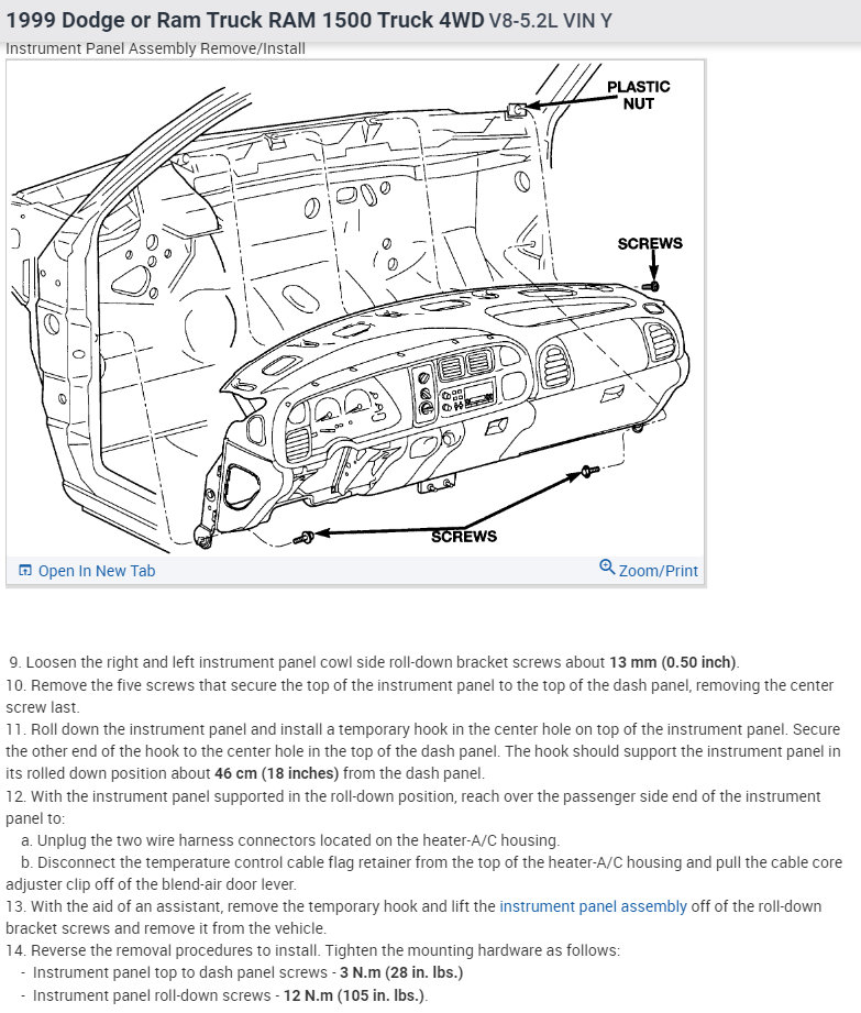

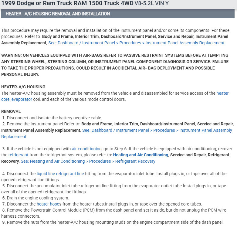

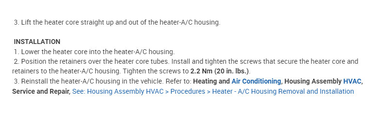

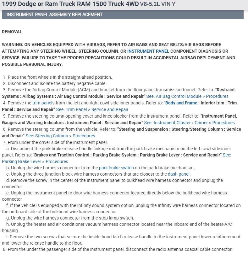

Hello. I'm retired now on disibility and chose to decided to replace the heater core myself due to the cost-- this may have been a huge mistake -- but I got the core and have spent a few hours trying to remove the old one-- question is-- How much of the dash do I need to remove?
Thanks in Advance for your help Bob
Monday, January 19th, 2009 AT 4:55 PM
SQM
  • 6,383 POSTS

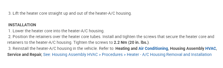

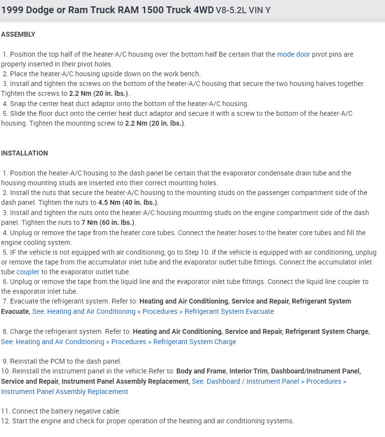

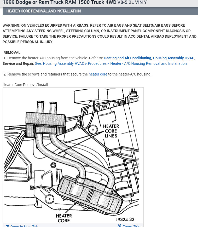

On this truck you will have to remove the complete dash assembly in order to replace the heater core.
https://www.2carpros.com/articles/replace-heater-core
I have attached the complete replacement procedure below.
