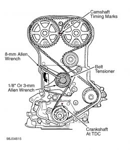

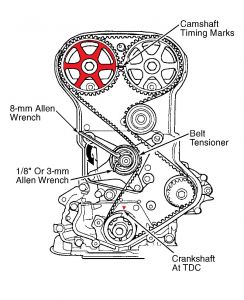

How do you set the timing on a 1997 dodge neon Dohc
Monday, May 12th, 2008 AT 8:57 PM
BMRFIXIT
  • 19,053 POSTS
https://www.2carpros.com/forum/automotive_pictures/99387_neon_dohc_2.jpg
https://www.2carpros.com/forum/automotive_pictures/99387_neondo_1.jpg
