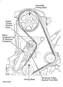

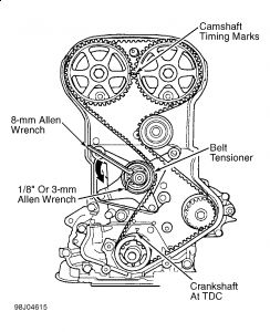

How do you set the timing on a 1999 Dodge Neon, is it up and down, the mark facing each other or going in the same direction?

Which engine? SOHC or DOHC?

I have both on file, see pics for information.

What if you put one of the timing marks upside down? It is running fine. Will it cause a problem?

If the engine is running smooth and compression is good in all cylinders than the timing belt is on correctly and its A OK. No possible way you could have installed it off of the timing mark and it run good.

The timing must be set as per pic, I could not imagine that it would run at all if one of the cams was that far out.
