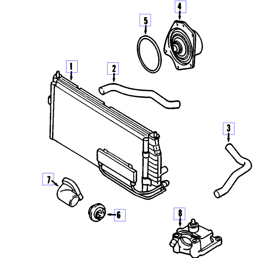

Coolant leaking from back of engine?
JOHNNY44
  • 2000 DODGE INTREPID
  • 6 CYL
  • FWD
  • 141,000 MILES
My 2000 intrepid 2.7L leaked about half a gallon of coolant leaking from back of engine between the transmission and oil pan underneath the car, where is it leaking from? Thanks John
Sunday, March 28th, 2010 AT 2:55 PM
SQM
  • 6,383 POSTS
You might have one of the coolant hose leaking.
Overtime the hose will get brittle and rupture. Typically when a hose ruptures you will loose a lot of fluid in short period of time. Sometimes the clamps can brake and the hose will pop off.
There are couple of small coolant bypass hoses that connect to the back of the engine. They have a tendency to leak after few years.
It is little tricky to get to but can be done with little bit of patience.
