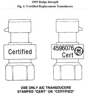

Could also be the a/c clutch coil. test the relay like this:
https://www.2carpros.com/how_to/how_do_i_check_a_relay.htm The clutch coil, or it's wiring is more likley the cause, a bad transducer tells The PCM the pressure is low or high and wont let the compressor run, in fact Chrysler has a Technical bulletin about their transducers being faulty from 93-95 models, and here's a picture of the replacement part.
https://www.2carpros.com/forum/automotive_pictures/62217_9395_ac_transducer_1.jpg
You can bypass the tranducer with a piece of wire, this will eliminate it as the source, but not the harness, DO NOT run A/c like this, damage to the compressor WILL occur! At idle and during recharging, until it's full enough to keep the compressor running(enough freon), then plug it back in, it's a safety switch.
I will email the TSB about this.
Check the wires to the compressor with an ohm meter, the colored wire should be the power... put red lead on it, ground the other lead, reading should be OL, if it shows a low resistance reading, it's shorted to ground.

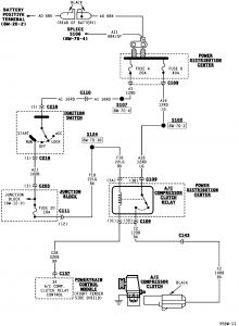

According to the schematic"”IF it was the A/C clutch coil the fuse should blow going to the A/C ---right but it doesn't? So, what I was referring to is the actually A/C relay coil side possibly grounding out where it goes to the PCM---not the relay contactor where the clutch coil current travels through it.
See Schematic below:
Intermittent troubleshooting problems like this can rack one's mind----But once again why would the PCM fuse blow and not the A/C relay fuse blow? The 10 amp fuse numbered 20 on the schematic above never blows. When the A/C cooling mode is in ON the PCM fuse will not blow right away but only after traveling for 20 miles or more and sometimes longer.
Is it possible the transducer has an intermitten short causing the PCM fuse to blow? Theory is 5 volts out but it could cause a short--thus --perhaps blowing the PCM fuse?

18 - 10 Amp
Engine Controller, Fuel Pump Relay, ASD Relay.
This the fuse blowing? I would start by checking grounds, This is a major cause of problems like this.
If you can scan for B and U codes, these require a good scanner, Most shops can read these, but the scanners sold at Autozone and stores like it do not. And try the self test, turn the key from off to on three times then leave it on on the fourth time. Count the flashes of the MIL(service engine light).
