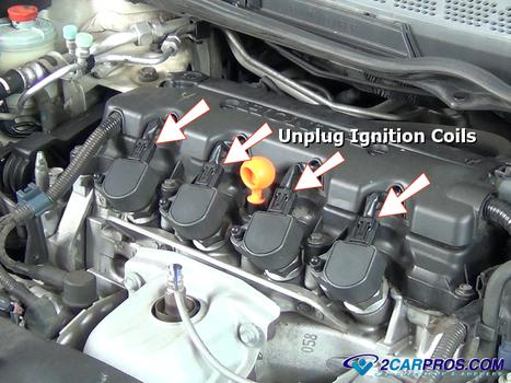

2. If none of these blows the fuse, unplug the ignition coils and try the experiment again by plugging the coils one at a time while the fuse is observed.
unplug ignition coils
3. Again if no results are gleaned do the same thing for the fuel injectors. These are the three main items that can cause the engine fuse to blow, oxygen sensors, ignition coils or the fuel injectors in that order. Nine times out of ten one of these three sets of items will be the problem. Simply replace the shorted part with a new unit and replace the fuse one last time and you are on your way.
