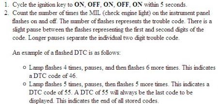

https://www.2carpros.com/forum/automotive_pictures/170934_dodge_intrepid_codes_1.jpg
Hello, can you check for codes? If you think it might be a spark issue, I use a digital multimeter as a basic test, touching the plug wires one at a time, engine running. It is an inductive reading, you don't take the plug wire loose and you don't penetrate the insulation, you just touch the meter lead to the wire. I look for the readings to be close on each plug wire. If most of the readings are close and maybe two plug wires that show almost zero, I know where to start. I'm not saying that is a conclusive test, but, as a basic first test, it works for me and you don't have to unplug anything. I just wanted to add, don't let any meter leads get wrapped-up in belt or fan, anything.
