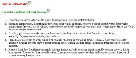

Where are all the mounting bolts located to remove heater housing I have found most of them but there is still something holding it back around center and do you have to remove blower assy before housing comes out

https://www.2carpros.com/forum/automotive_pictures/261618_Noname_2866.jpg
https://www.2carpros.com/forum/automotive_pictures/261618_Noname2_940.jpg
