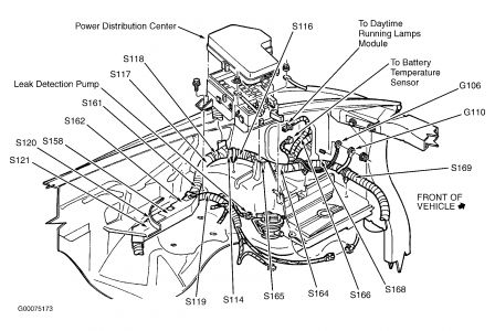

The truck was running fine, but low on gas, drove 1 mile to store, came out and the truck turns over but dies. Cannot locate the fuel filter or fuel pump. Recently changed gas caps to a NON lock one with winter approaching. HELP! It turns over but dies

Pump is in the tank
check for fuel pressure
check for spark
add gas and listen if the fuel pump coming on when 1st key on

My dodge durango will not start, changed the fuel pump and fuel filter, still same problem. Fuses all good. No gas is getting through, what in the world can it be? Help, I am lost with no answers. Thanks so much in advance

DO U HAVE SPARK !
CHECK ASD RELAY AND CRANK SENSOR

How do I check those things, sorry I am woman who knows nothing about ASD or crank sensor. Thanks

Check under the hood in the power distributor center
locate ASD relay
mark it and switch it with another similar relay
https://www.2carpros.com/forum/automotive_pictures/99387_durango98_1.jpg
As for the crank sensor is located rear right top of engine
