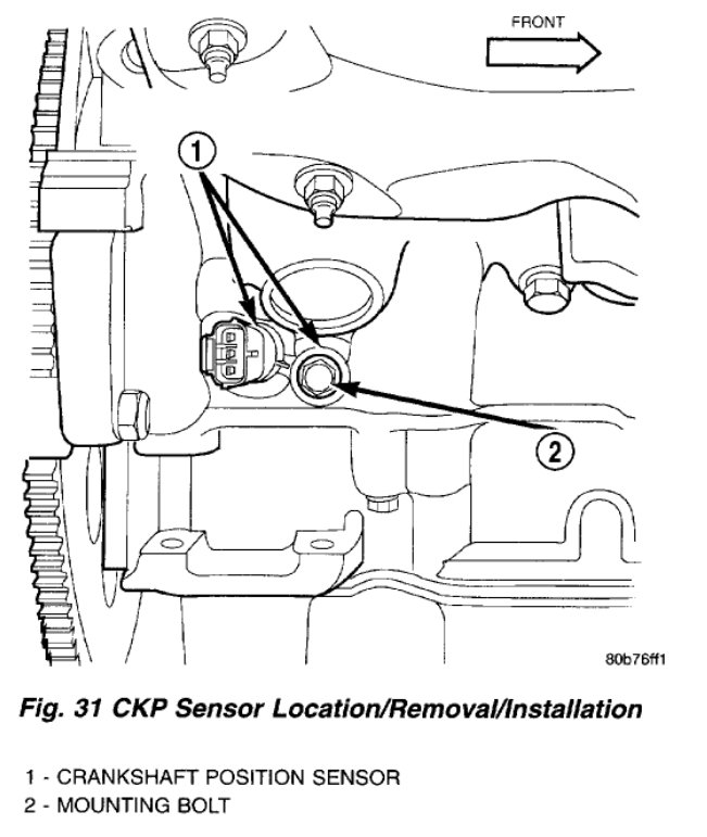

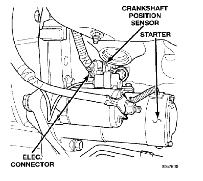

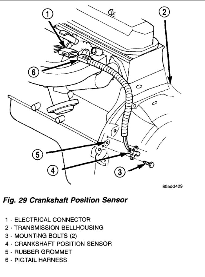

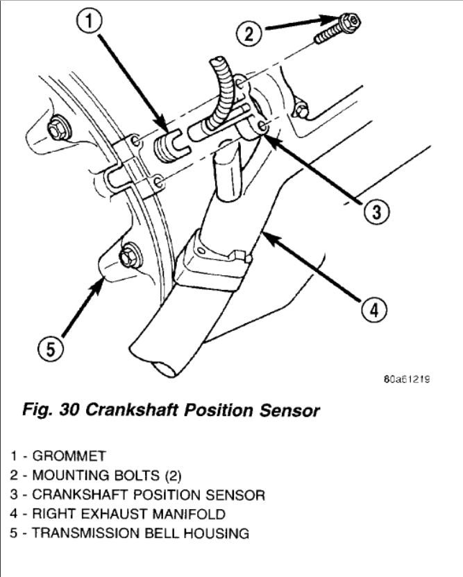

KEN L
  • MASTER CERTIFIED MECHANIC
  • 55,488 POSTS
This sounds like a crankshaft angle sensor that is going out. When the engine wont start does it have spark? Here is a guide to show you how to check
Here is a guide to help you see what you are in for when changing a crankshaft angle sensor.
Here is what it will be like on your car (below) I included all three engine so it will help others
Please let us know what you find. I'm interested to see what it is.
