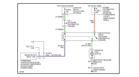

2000 dodge dakota 3.9 V6 5spd Check engine light is on. Code P1491 MFR controlled aux emissions controls Any ideas what this might be. Got word that it might be a relay in the fuse box under hood to control the ecectric fan on radiator. Not able to locate that from an autoparts store to try it. Any help there either.

EC P1491 Radiator control fan relay
The relay is in the power distribution center and the circuitry is below
https://www.2carpros.com/forum/automotive_pictures/12900_2000_dodge_dakota__Fan_control_relay_circuit_1.jpg

Thank you very much I will see if I can locate that relay. Your help is greatly appreciated.

Any ideas on a part number or any number to help locate the part.
Wednesday, October 17th, 2007 AT 3:34 PM
  • 75,992 POSTS
P/N 04886288AA
Thursday, October 18th, 2007 AT 4:17 AM
DABOOCRU02
  • 18 POSTS
Thank you very much. I have found the part at a local chrysler dealer. It will be in monday 10/22. I will put it in and reply with the results. Thanks again for the help!

I installed the part today. The part number they gave me was 4671168. That is what they were able to look it up for me at the dealership. Either way it is installed and I drove to a couple of places tonight and the check engine light has gone off. Thank you so much for your help. Greatly appreciated.
