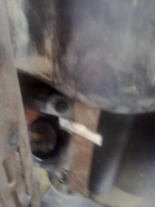

Break lights wont go off, Tried pulling peddle up that did not work. Any other ideas?
Sunday, July 28th, 2019 AT 5:51 PM (Merged)
BLUELIGHTNIN6
  • 16,542 POSTS
The brake light switch, located just above brake pedal, has most likely failed. Get underneath driver side dash and inspect the switch to ensure it's plunger isn't just stuck open. Most likely it will need replaced though.
BLADESDAD
  • 6 POSTS
I looked and it looks like the break light switch is missing all together I took a pic The silver thing is attached to the peddle it looks like something is supposed to be there. I'm guessing the switch but not sure

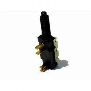

BLUELIGHTNIN6
  • 16,542 POSTS
Hard to tell anything from that pic but the switch should look similar to pic below
