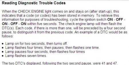

You should be able to check for codes by cycling the ignition switch. You turn the key till the dash lites come on, no further. On--off, on---off, on. The check engine lite starts flashing on the dash, you count the flashes to get the codes.
Thursday, September 7th, 2017 AT 5:27 PM
LEMASTER7
  • 10 POSTS
The flash code displayed is 35255. Can you tell me what that means?
JDL
  • 16,098 POSTS
https://www.2carpros.com/forum/automotive_pictures/170934_dakota_codes_1.jpg
The codes should be two digit codes, when you run them together it is hard to tell. The code 55 would be end if message, it always comes last.

Guys, I'm having a problem reading the check engine light flash code. I know these are supposed to be 2 digit codes. Here's what happens during flashing:
1 flash then a short pause then two flashes, then a 4 sec pause then 5 flashes then a short pause then 2 flashes then a 4 sec pause then 5 flashes then a short pause then 5 flashes then light goes off and remains off. The short pause is about 2 seconds long.
The codes could be 12 and 52 with the 55 as the ending sequence. If that's the case, what is my problem? Fuel pump, O2 sensor, crank sensor, MAP sensor or what?
JDL
  • 16,098 POSTS
Hello, the code 12 means the battery voltage has been lost at some time. The 52 is 02 sensor, system running rich. That doesn't mean the sensor is faulty. The system may be running rich for some reason? I'd check the fuel pressure for a start.

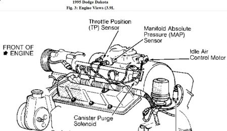

Thanks for the response caradiodoc. I found an online site that gave me detailed instructions on how to do a bench test on both the oxygen sensor and the MAP sensor using a digital volt meter on both and a torch for the O2 sensor and a hand vacuum pump for the the MAP sensor. I know where the oxygen sensor is but I don't know where the MAP sensor is located. Could you help me out here?
Thanks to all,
John
ZACKMAN
  • 4,202 POSTS
https://www.2carpros.com/forum/automotive_pictures/55316_95dakotamap_1.jpg
CARADIODOC
  • 34,468 POSTS
It's screwed into the driver's side of the throttle body and has three wires on it. Don't waste your time testing it; just find a good used one in the salvage yard and stick it in. Older units had a vacuum hose that you could remove and attach a pump to. Yours has a threaded fitting.

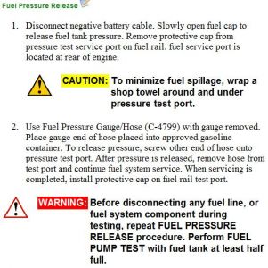

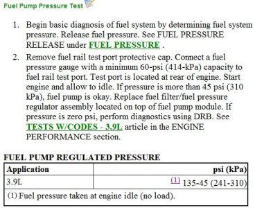

I have replaced the oxygen sensor, plug wires, dist cap and rotor. No change with these part additions--Engine will not start after warmup.I finally found a fuel pressure gage at Advance Auto. Here is the test results:
Key on pressure---34 psi steady gage.
Pressure at idle----34-40 psi rapid cycling of gage.
Pressure at 1500 rpm and higher----38 psi steady.
Are these the pressure readings I should be seeing? Where do I go from here?
Thanks, LeMaster7
Thursday, September 7th, 2017 AT 5:28 PM
ZACKMAN
  • 4,202 POSTS
https://www.2carpros.com/forum/automotive_pictures/55316_95dakotafuelpressure0_1.jpg

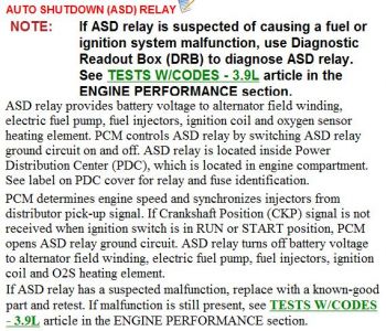

You may also want to consider testing if not replacing the ASD relay.
https://www.2carpros.com/forum/automotive_pictures/55316_95dakotaasdrelay_1.jpg

Thanks for the reply Zackman:
I will perform tests as you suggested. By the way I noticed a typo on the regulated pressure chart--range should be 35-45psi not 135-45. Spec is 40 psi plus or minus 5.
Thanks, LeMaster7
ZACKMAN
  • 4,202 POSTS
It is 35 - 45. 240kPa is equivalent to 35psi.
