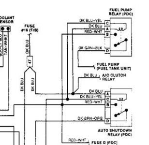

The truck ran a few days ago but it was hard to start. Now it wont start. I dont hear the fuel pump pushing gas. I was suggested to checking, and replacing, the Automatic Shut Down (ASD) Relay. This is what sends power to the fuel pump and it is not uncommon for it to go bad. It is a lot cheaper and easier to replace the ASD relay than the fuel pump. I was told to the the splicing of these wires under the relay box get corroded and needs to be re soldered together. What else can I check. I was switch relays around I think thats why I got code 33. I'm going to take my relays to be tested then move from there.I have no fuel pressure.

Hi, thanks for the donation. Check the fuse in the diagram, fuse # 16 I believe, use a testlite, see if fuse circuit is hot.

Number 16 fuse is good.

Dark blue wire with white tracer is voltage for coil side of relay. Red wire with white tracer is voltage for switch side of relay. Check circuits for voltage.

I dropped my fuel tank and tested the fuel pump and it does not work.I jumped the leads to my battery and it does engage. So I think that my pump is bad. I reset the battery to clear the codes. I didn't have the codes until I started messing with the relays.
