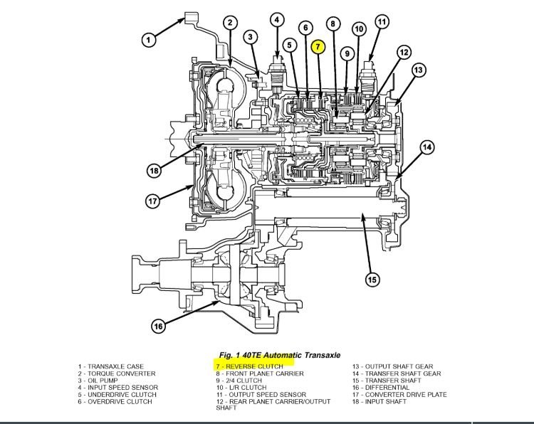

These transmission had a problem internally with the clutch pack seal that engages reverse. The only fix is to remove the transmission and rebuild it. But to be sure scan the car for codes to see if there is a speed sensor error, also there is a chance the TCM has gone out which would scan the codes to determine.

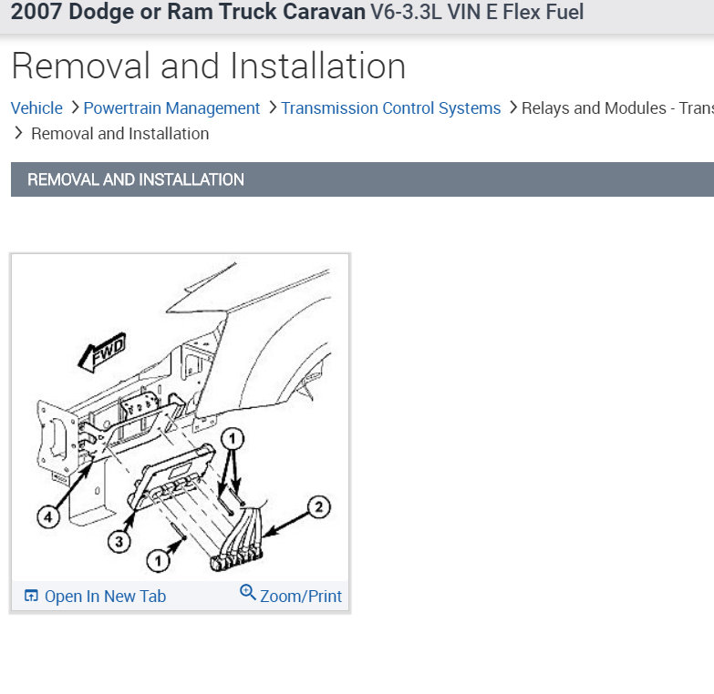

Also I have included the TCM replacement instructions in the diagrams below. Check the electrical connector because they can get moisture in them. Check out the diagrams (Below). Please let us know what happens.

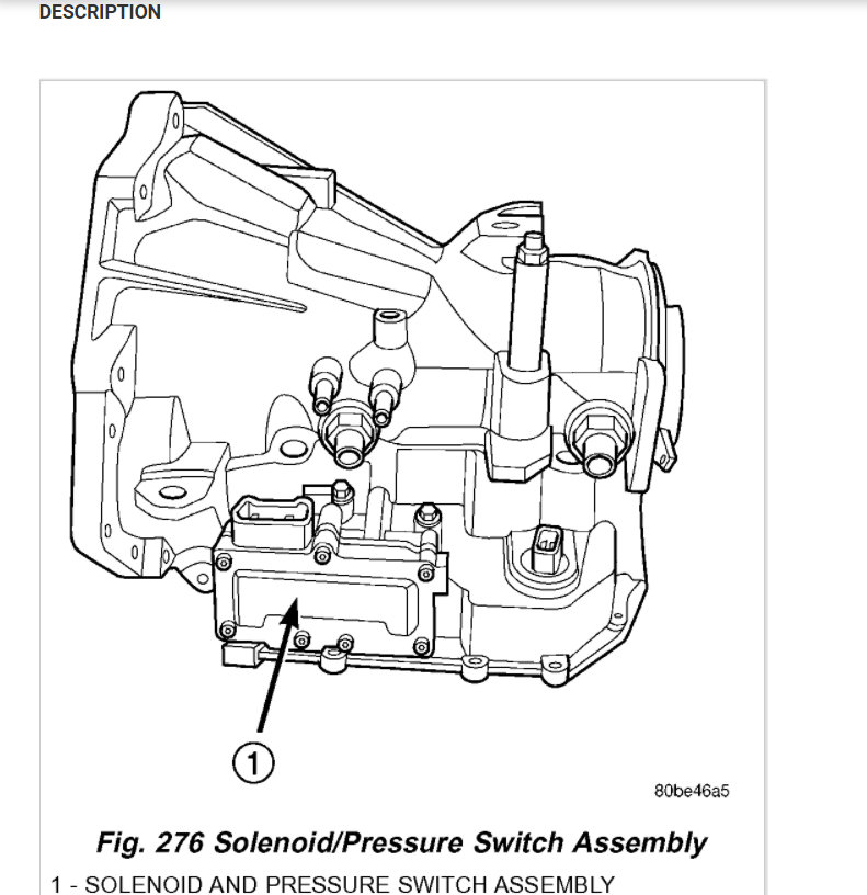

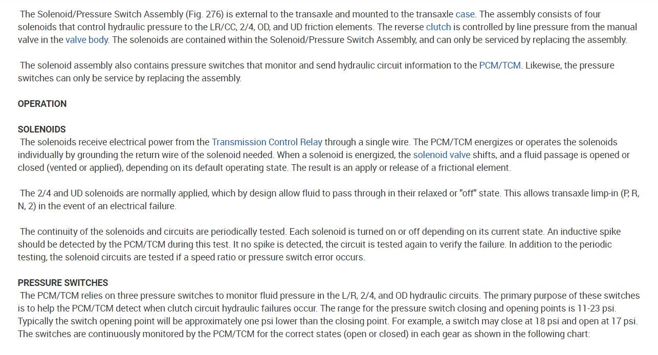

I attached the description for you of the no reverse.
There is no solenoid control for this. It is mechanically controlled by the valve body. Good chance the clutches are worn out. The transmission will need to be removed and inspected.

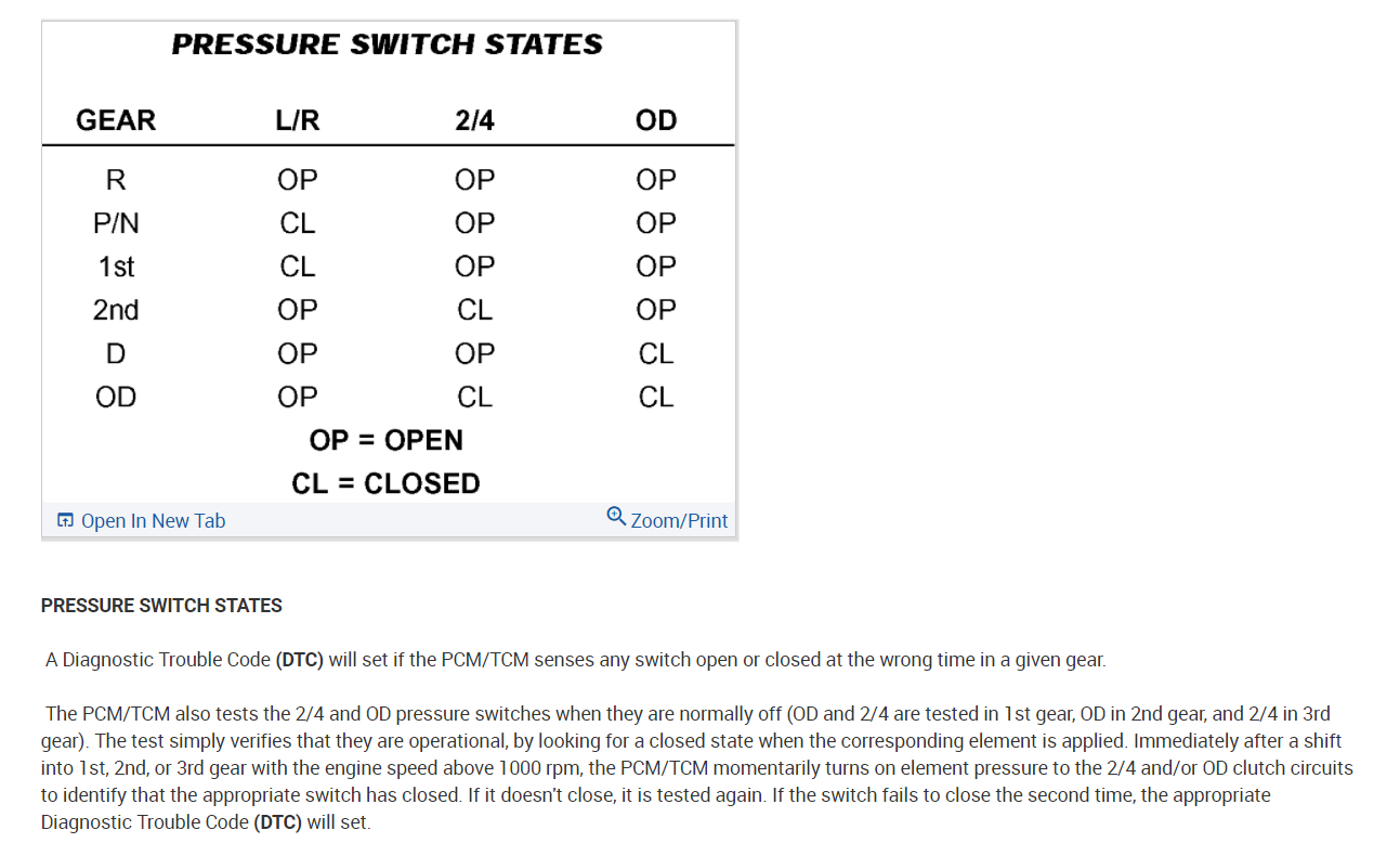

The 732 is for incorrect gear ratio to second gear which indicates slippage internally. This goes back to internal issues with the transmission.
P0732
Descriptor
Gear Ratio Error In 2Nd
Probable Causes
Intermittent Gear Ratio Errors
Internal Transmission
Internal Transmission Failure
Low Transmission Fluid
Pressure Switch
Related Diagnostic Trouble Codes (DTC's) Present
Related Pressure Switch Diagnostic Trouble Codes (DTC's) Present
Transmission Internal Damage
Transmission Solenoid
Transmission Solenoid and or Pressure Switch Assembly

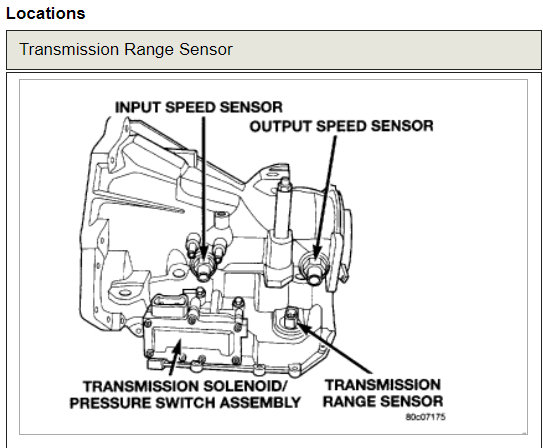

It sounds like one of two things has happened first does the light for the reverse gear selector light up when in reverse? If the light is not working it can be the transmission position sensor is out. Here is the location of the sensor.
If the light is working then it sounds like the transmission has had an internal failure and needs to be rebuilt.

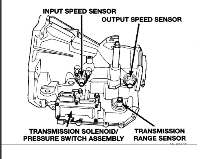

I have seen this problem before the transmission position sensor goes out causing the transmission not to go into reverse. Here is the location so you can get the part replaced.
Cheers
+5
Friday, May 21st, 2021 AT 2:50 PM (Merged)
JACKMAN911
Thank you very much for your quick response. I picked up some trans fluid and filter today and was going to change this weekend because it has not been done and after the sensor replacement the trans has never felt better all gears are good including reverse!
