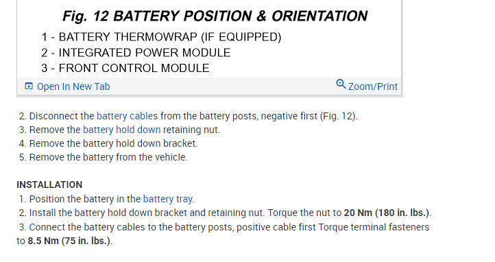

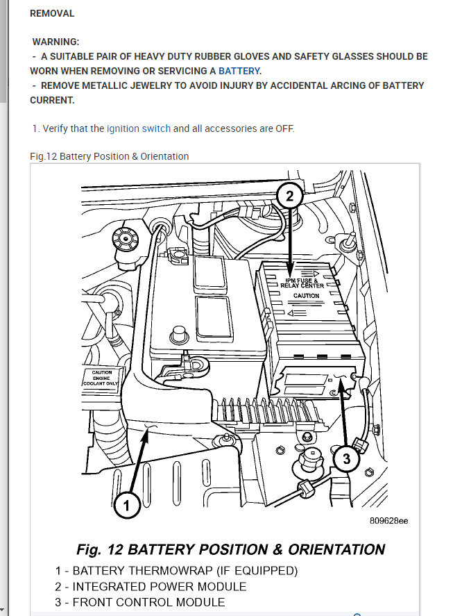

Sounds like you have a possible battery issue. However, we need to run through the basic systems first to rule out a battery.
Here are a couple guides that will help with this:
https://www.2carpros.com/articles/how-to-replace-a-car-battery
https://www.2carpros.com/articles/symptoms-of-a-bad-car-battery
Once we know what the battery is doing we can go from there. However, it is unlikely that the starter is the issue simply because it seems to be working and it will not cause the engine to stall.
Which points back to a battery issue. Please see below on how to replace the battery if this is what it turns out to be.
