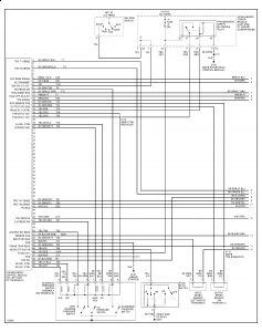

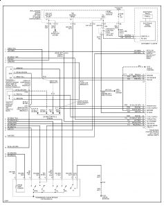

The only code it pops is P0605. I have cleared it and it re-appears immediately. I have checked continuity on all 31 wires of the tcm to the corresponding connectors.
What sequence of voltage checks should I make next? Engine running or ignition on, in gear or park?

BMRFIXIT
  • 19,053 POSTS
This DTC will set if an internal TCM malfunction occurs
Check all pin and make sure none is pushed out
check fuses and relay with key on engine on and or running
record all DTCs and erase codes
turn ignition on and then start
move the gearshift lever slowly through each gear position
if DTC return, replace TCM

CHAZ_S1
  • 7 POSTS
Thanx for the reply! I have checked volt.S
I have swapped out relay with identical working relay
All fuses ok.
I have 13.6 when eng. Running on Yellow/red(pin56)to tcm
There is no voltage from tcm(pin16)or(pin17) back to relay and sol. Switch yellow/org
There is no voltage from relay to tcm(pin15) yellow/brn
I do get a small variable voltage as the ign switch is turned to start, but goes away
My meter shows neg. Polarity when put in gear on the 3 wires mentioned above and back to pos. Polarity in park
Only P0605 shows
+1

BMRFIXIT
  • 19,053 POSTS
https://www.2carpros.com/forum/automotive_pictures/99387_Graphic1_506.jpg
https://www.2carpros.com/forum/automotive_pictures/99387_Graphic2_245.jpg

CHAZ_S1
  • 7 POSTS
Thanx for the diagram, I can't view it. The size and resolution are too low.
With no voltage out to relay, and all wiring, connectors, and fuses appearing good. What could I look for next?
Friday, June 26th, 2020 AT 1:01 PM (Merged)
BMRFIXIT
  • 19,053 POSTS
Bad TCM

CHAZ_S1
  • 7 POSTS
Thanx for the insights, it WAS a failed TCM.I replaced it and now runs fine. So thank you all at 2CARPROS!

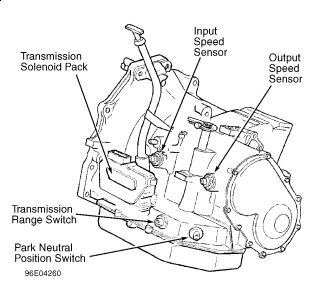

I have a 2000 Dodge Grand Caravan 3.8L 146k miles.
It shifts ok when I first turn it on but shifts at wierd rpms. But when the engine/transmission warms up, its in Limp Mode and wont get out of 1st gear.
Could it be the input and/or the output speed senors? Or a vacuum hose? Please help!
BMRFIXIT
  • 19,053 POSTS
https://www.2carpros.com/forum/automotive_pictures/99387_Graphic9_36.jpg
Need to check for codes
suspect tranny solenoid pack and or speed sensors
good luck
