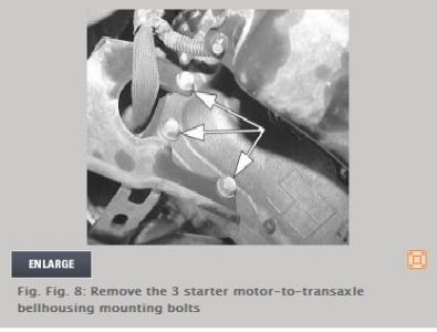

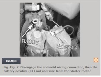

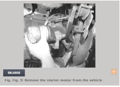

Welcome to the forum, take the negative battery cable loose. The pictures below, came from autozone.
https://www.2carpros.com/forum/automotive_pictures/170934_starter_removal_1_1.jpg
https://www.2carpros.com/forum/automotive_pictures/170934_starter_removal_2_1.jpg
https://www.2carpros.com/forum/automotive_pictures/170934_starter_removal_3_1.jpg

1. Disconnect battery ground cable, then raise and support vehicle.
2. Remove starter motor attaching bolts and nuts.
3. Disconnect all electrical connectors from starter motor and remove starter.
4. Reverse procedure to install.
