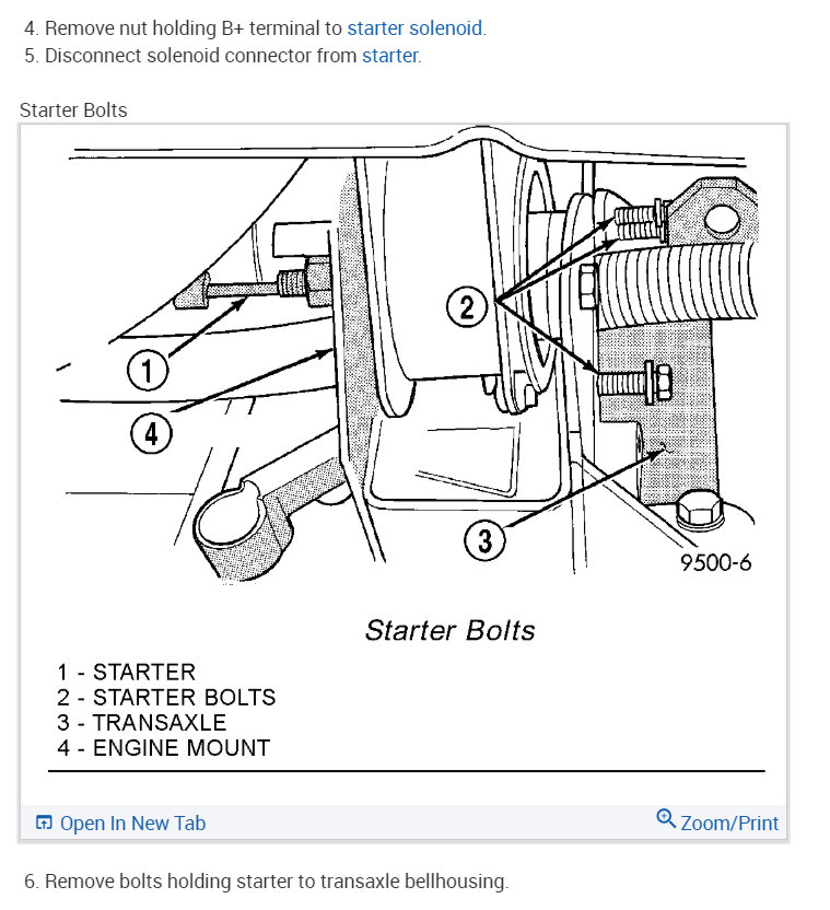

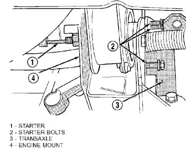

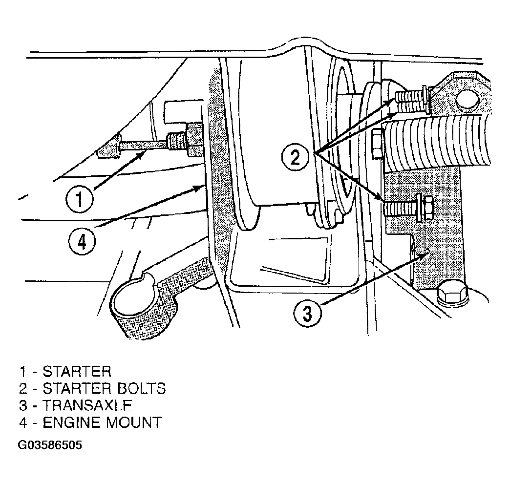

Im sure what the bolts look like on the starter I want to replace it?
Wednesday, October 14th, 2009 AT 10:31 AM
17 Replies
JDL
  • 16,098 POSTS
Here is a guide to help walk you through the steps with instructions in the diagrams below to show you how on your car.
Wednesday, October 14th, 2009 AT 10:40 AM
DJRED2YA
Ok is thier a way to remove the top bolt and thanks the diagram did help.
+3
Wednesday, October 14th, 2009 AT 6:24 PM
JDL
  • 16,098 POSTS
Yes you can use a long extension and universal.

I would like to know where to locate the starter on my 2005 Dodge Grand Caravan? It is a 3.3L 6-cyl. (No flex fuel)
+3
Monday, January 6th, 2020 AT 11:47 AM (Merged)
  • 110,194 POSTS
Hi:
The engine is transverse so the starter will be located on the front of the engine near the oil filter. You will need to lay under the front of the van to see it.
I hope this helps. If you have any other questions, let me know.

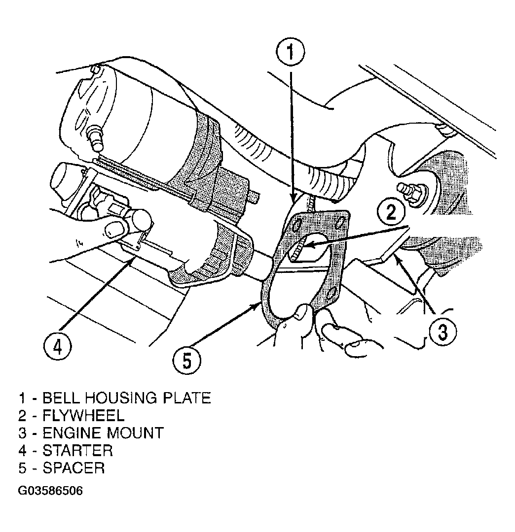

MERLIN2021
  • 17,250 POSTS

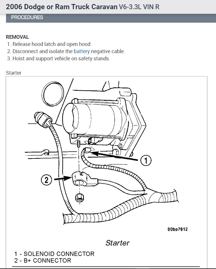

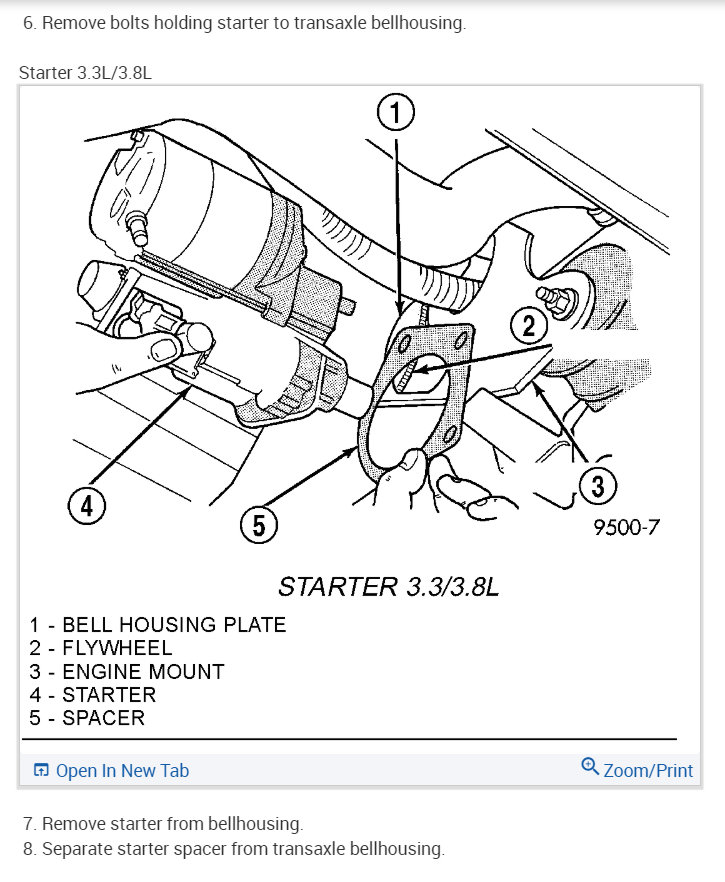

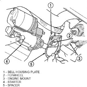

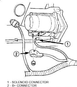

REMOVAL - 3.3/3.8L 1. Release hood latch and open hood. 2. Disconnect and isolate the battery negative cable. 3. Hoist and support vehicle on safety stands. 4. Remove nut holding B+ terminal to starter solenoid (Fig. 7 ). Fig. 7: Identifying Starter Components Courtesy of DAIMLERCHRYSLER CORP. 5. Disconnect solenoid connector from starter. 6. Remove bolts holding starter to transaxle bell-housing (Fig. 8 ). Fig. 8: Locating Starter Bolts Courtesy of DAIMLERCHRYSLER CORP. 7. Remove starter from bellhousing (Fig. 9 ). Fig. 9: Locating Starter 3.3/3.8L Components Courtesy of DAIMLERCHRYSLER CORP. 8. Separate starter spacer from transaxle bell-housing.
INSTALLATION - 3.3/3.8L 1. Place starter spacer in position on transaxle bellhousing, flange toward flywheel. 2. Place starter in position on bellhousing. 3. Install bolts and ground wire (Fig. 6 ) to hold starter to transaxle bellhousing. 4. Connect solenoid connector into starter. 5. Install nut to hold B+ terminal to starter solenoid. 6. Lower vehicle. 7. Connect battery negative cable. 8. Verify starter operation.
Before installing the new starter, the accumulated grease and grit must be cleaned from the bell housing and spacer to insure the new starter sits perfectly flat. Also it'd be nice to know the torque specs for the starter bolts.

Would like to see a Diagram showing the
bolt locations that affix the starter Assembly to
the engine proper. Can't see all the bolts from
underneath. How many bolts are there?
Monday, January 6th, 2020 AT 11:48 AM (Merged)
CARADIODOC
  • 34,491 POSTS
Sorry that I can't upload a photo, but there's two bolts. The starter is right in front, and the bolts have 15mm heads. For the upper one you might need a swivel for the socket and a 6" extension.
