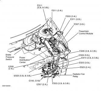

The engine coolant temp. sensor is located on or next to the thermostat housing, except for the 3.0L engine..in that case it is near the distributor.
if you are talking about the cooling fan relay, it is at the front of the left frame rail, picture below

recently temp gauge start rising, car got hot. Replaced two fan the hold assembly, fans still wont start and engine run hot, what is the fix to this problem. Relays or fuses or control module, ? Where located and what to replace to get cooling system normal. Thanks for you time.
Friday, May 26th, 2017 AT 7:03 PM (Merged)
BMRFIXIT
  • 19,053 POSTS
https://www.2carpros.com/forum/automotive_pictures/99387_Graphic1_385.jpg
Check thermostat
check fuses
and if all ok suspect fan relay module
located Front of left frame rail
good luck
