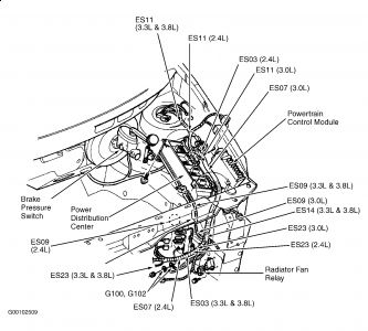

fans do not come on. Tested fan itself it works. Fuse is good. Understand there are two relys for the fan but can't locate them, any idea. Car will over heat at an idle, but not while driving. Turn air on fans do not come on can you help? Thank you.

Check this 1st and let me know
https://www.2carpros.com/forum/1998-dodge-caravan-engine-running-hot-vt294351.html?highlight=

Can you tell me where the coolant sensor is on 99 Caravan? Also, do you have a diagram or picture of WHERE the Relay is at? The fan will not come on and I know NOTHING about cars :( Thanks for any help you can provide
