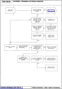

I stop and got gas this morning. Got back in went to start it. Nothing at. Won't crank, no light no nothing.
Tried to start in a couple of times, then it starting to click behind the fuse box when the key was turned off. Open the door the clicking got worse. Turn the key to the on position and the clicking stops. I disconnected the battery for now. Which by the way stopped the clicking also. I check fuses and what not. Any Ideas? I was thinking maybe the asd relay, or maybe the neutral switch? Any help would be greatly appreciated. Thanks.

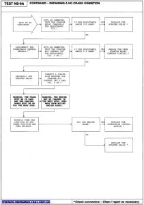

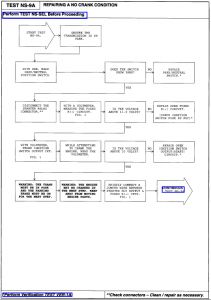

First make sure your battery is fully charged and you have a good connection.
than folow this chart
https://www.2carpros.com/forum/automotive_pictures/157695_no_crank_1.jpg
https://www.2carpros.com/forum/automotive_pictures/157695_no_crank_2_1.jpg
https://www.2carpros.com/forum/automotive_pictures/157695_no_crank_3_1.jpg
that ought to help ya just follow the trail
