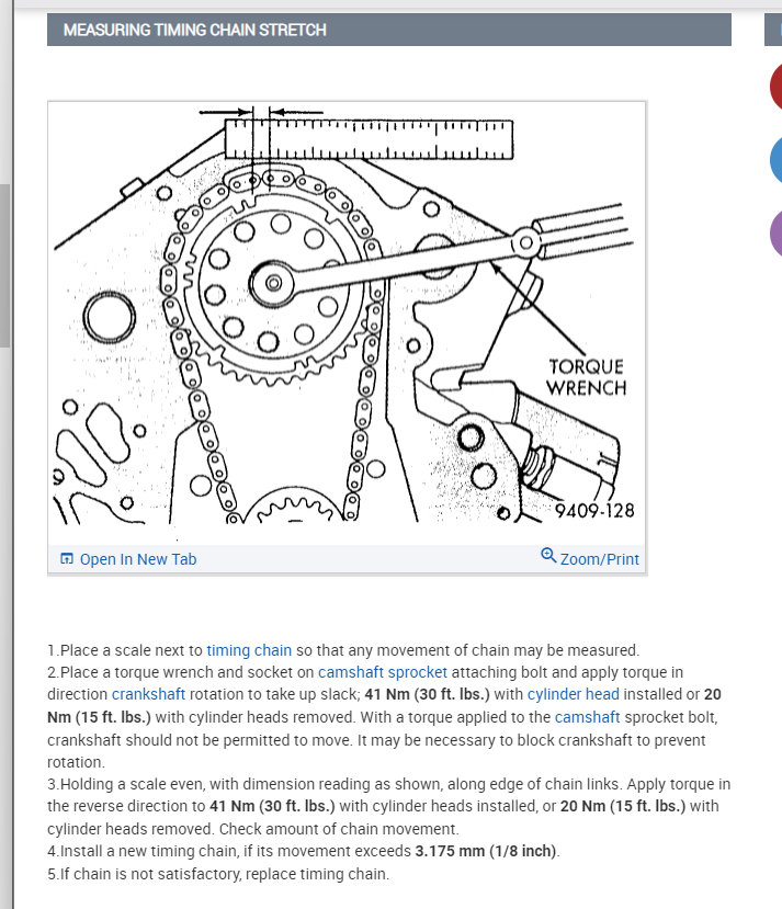

Once we get through this guide, we are going to have to check the timing and the timing chain to make sure it has not stretched.
The fact that you have better operation going uphill points to a load related issue which can be timing.
So please see the info attached on how to check this.

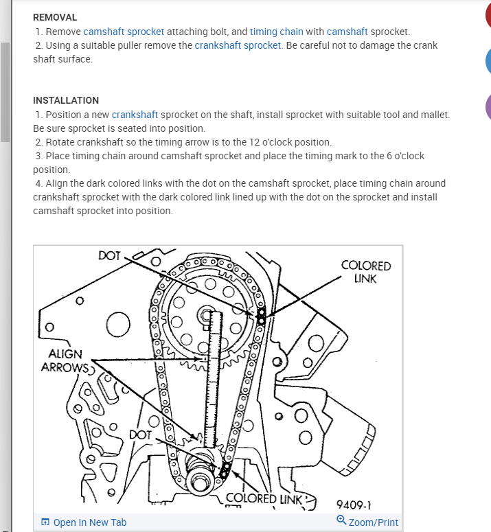

If the timing chain is stretched or not timed correctly then we need to replace the chain.
I attached the info on this as well.
