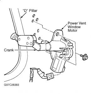

I have a 1997 Dodge Grand Caravan. The heater panel has a driver and passenger setting for the heat to be cool or hot. The driver side is set to hot and works great while the passenger side is also set to hot but blows cool air out. Why does the driver side blow hot air and the passenger side blow cool air? Also how do you get the passenger side rear window to open? Where is the motor for this?

Removal & Installation (Left Side)
Remove rear header trim cover. Remove liftgate sill plate. On long wheelbase models, remove second rear seat belt turning loop. On short wheelbase models, remove bolt securing second rear seat belt lower anchor to quarter panel.
On all models, remove jack storage cover. Remove "D" panel retaining screws. Using a trim stick, gently pry around perimeter of "D" pillar trim panel and separate trim panel from inner quarter panel. Disconnect rear speaker connector (if equipped).
On short wheelbase models, pass seat belt through slot in "D" pillar. On all models, remove "D" pillar trim panel. To install, reverse removal procedure.
Removal & Installation (Right Side)
Remove quarter panel trim bolster. On all models, remove "D" panel retaining screws. Disengage hidden "D" pillar trim panel clips. Separate "D" pillar trim panel from "D" pillar. Disconnect rear speaker connector (if equipped). Remove trim panel. To install, reverse removal procedure.
Disconnect power vent motor connector. Remove nut securing crank to vent glass. Remove bolts securing power vent motor to "D" pillar. Remove power vent motor. To install, reverse removal procedure.
