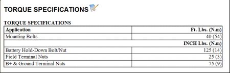

REMOVAL & INSTALLATION (3.3L)
1. Disconnect negative battery cable. Remove alternator drive belt. Loosen, but DO NOT remove nut on support bracket at exhaust manifold. Remove alternator tensioner power steering bracket bolt. Remove tensioner stud nut and tensioner.
2. Remove alternator mounting bolts. Remove power steering reservoir from alternator mounting bracket. DO NOT remove hoses from reservoir. Remove alternator support bracket bolts. Remove intake plenum-to-alternator mounting bracket bolt. Remove alternator support bracket.
3. Move alternator aside, and remove alternator wiring. Remove alternator. To install, reverse removal procedure. Tighten fasteners to specification. See TORQUE SPECIFICATIONS table.
https://www.2carpros.com/forum/automotive_pictures/248015_Caravan_Alternator_1.jpg
Sorry my friend. . .. . .. . ..no pics on this one. . .. . .. . ...I hope this helps you out.
It will be frustrating since you have to move so much stuff but just go slow and it will come out of there. Keep the sledge hammer near. . .. . .. . . :)
No worries on the amount of the donation. . .. . ...that is what we are here for. You do what you can. When the lotto folks show up at your door. . .. . ..then drop us a few more coins. . ...until then thanks for what you gave and good luck.

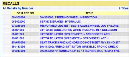

Hey one other thing before I let you go. . .. . .. . ...
Also, it looks like you may have some recalls on your vehicle. The dealer may fix these for free. Please contact the dealer service department, give them the VIN number of your car and have them check on these to see if they apply to you.
