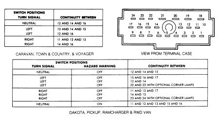

Do you have a test light? Try unplugging the connector to the fan, connect either a voltmeter or test light and see if there is power when the engine warms up. if yes the fan itself is ng!
Or you could test it by a length of wire fro the battery, see if the fan runs...
https://www.2carpros.com/forum/automotive_pictures/62217_Multifunction_1.jpg
If you are up to testing the multifunction switch, here's how! If it's good, there's probably a bad wire!
