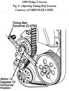

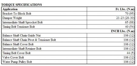

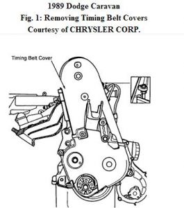

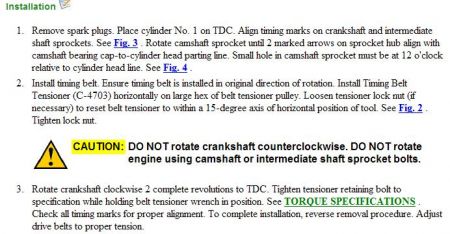

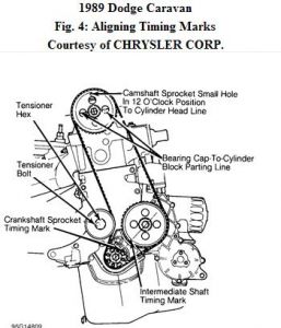

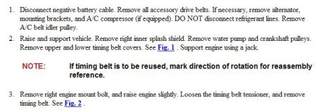

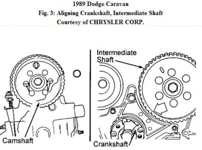

how do I replace a timing belt for a 1989 dodge grand caravan? And what tools might I need?

Just basic mechanic tools needed (i.e. socket sets, screwdriver, wrenches etc...) unless otherwise stated in replacement procedures, found below..
Removal
Let me know if you need further assistance..
