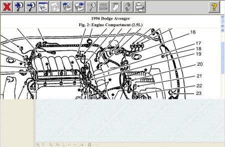

Hi guys, I am posting this for a friend. His transmission went out, so he went out and bought another from a junkyard. After installing the transmission, the car started, ran for about 3 seconds, than died. Has not fired since. Doesnt even turn over, acts as if the starter is bad, but its not they tested it. Any ideas on where to go from here?
They said something about the transmission computer being bad, I wasnt aware of the tranny having its own computer. Jus thought id throw that in there to see if it does or not. And if that could be the problem, also whats the name of that part

So is it true tho that this car has a seperate computer controlling the transmission? I asked if he was referring to the solenoid and he said no the transmission computer?
Tuesday, February 12th, 2008 AT 5:50 PM
  • 75,992 POSTS
Yes it has a TCM-for 2.5L its located at no.20 see below.
I didn't read your post right-answer this : Does it crank over and refuses to start or won't crank engine over at all.
http://www.2carpros.com/forum/automotive_pictures/12900_tranny_ecu_1.jpg
