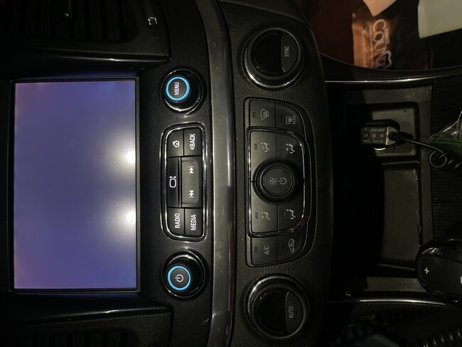

It is automatic digital climate control. I added a picture, actually 2 pictures. Or tried to, of the unit. I’ll try to send them again.

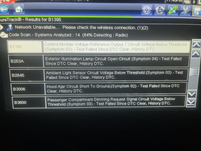

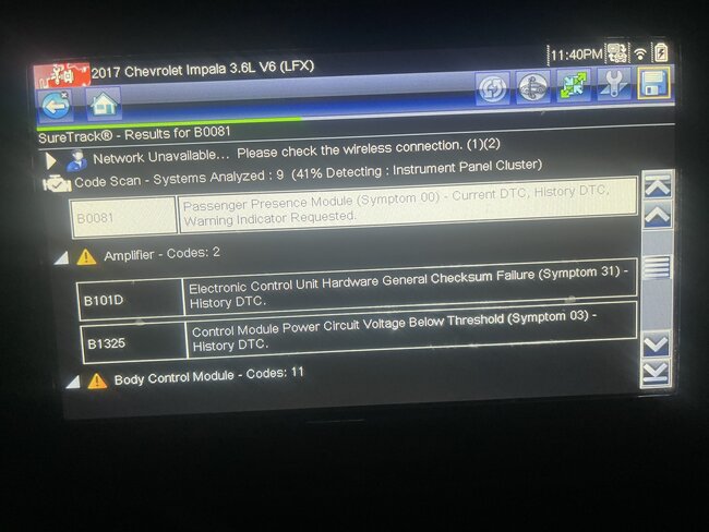

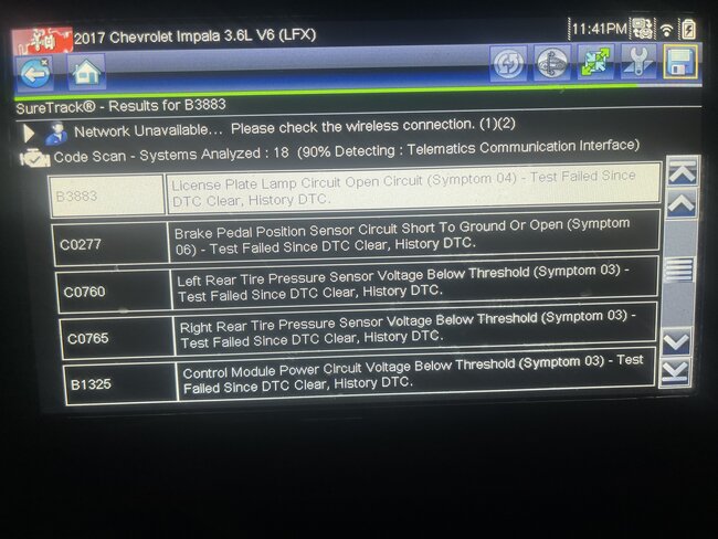

Here is a screen shot of the codes that my scanner gave me. I wasn’t able to hook to a Wi-Fi network where I scanned it at. I might be able to do that tomorrow. But if the codes that are shown in the pictures I have added, tell you anything, or she’s light on a certain procedure that I need to do, could you please let me know what to do?
Is it something that the scanner can fix?
Is it something that needs to be replaced?
I agree with you that it shouldn’t be a fuse, or an unconnected wire harness if the screen lit up for a second.
That’s why I shared that info with you.
Please let me know where to go from here, based on the scan codes listed in the pictures. Thanks again.

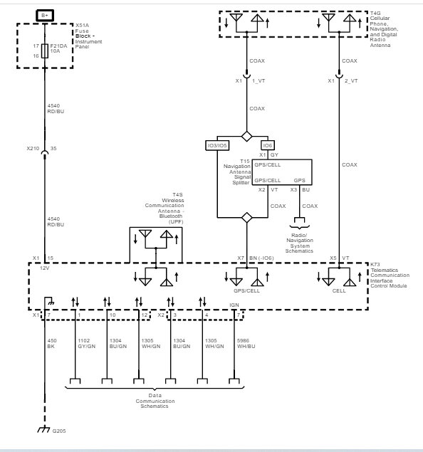

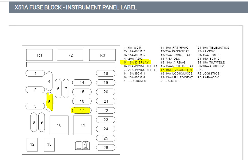

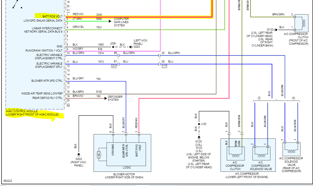

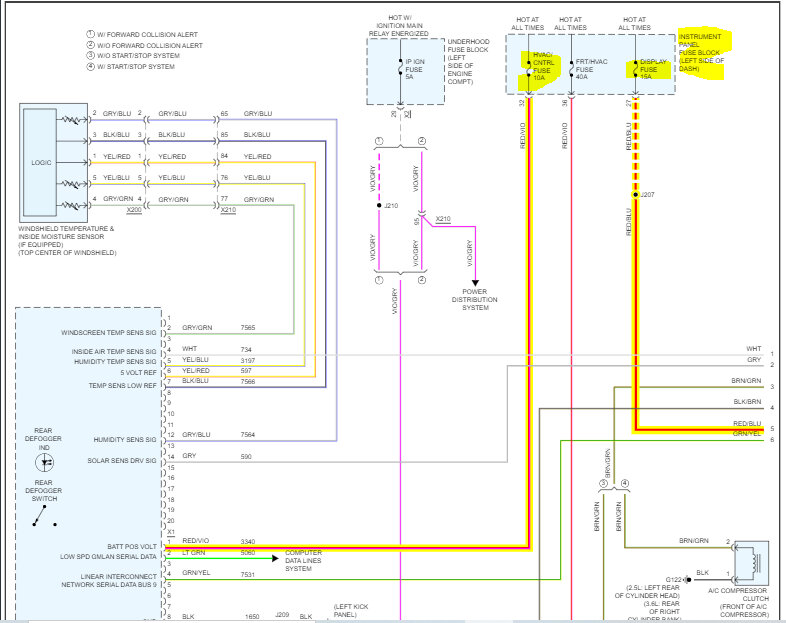

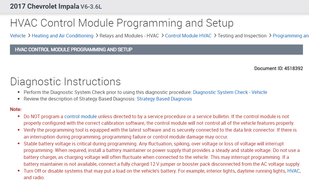

As far as the issue. I attached a portion of the schematic below. (See pics 1 and 2) I need you to start by checking two fuses in the interior fuse box. I highlighted them in pic 3.
When you check fuses, it is also important to confirm there is power to and from them.
Here is a link that explains how it's done:
Start with this and let me know the results.

I checked both fuses you highlighted. They are both good.
Key turned to accessories mode, 11.5 v reading from driver info cluster for battery voltage.
Both pins on each fuse showed 11.5v on them. So, no problems there.

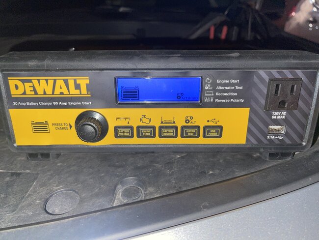

Ran my Dewalt unit on Alternator test mode and it came up good as you can see in the picture. I the voltage when the car is on accessory mode (not running) was at 11.5v and when the car is started, with lights on, radio on, goes up to 14.7 range, and stays there until it’s turned off.

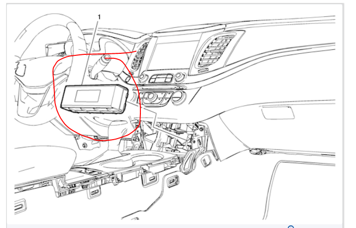

Answer me this. Would the module in the rear dashboard/rear window, near the brake light in the center of rear window. Would that module have anything to do with the HVAC?
Would the HVAC Module be under the glovebox by chance?

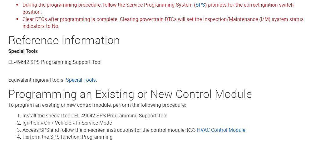

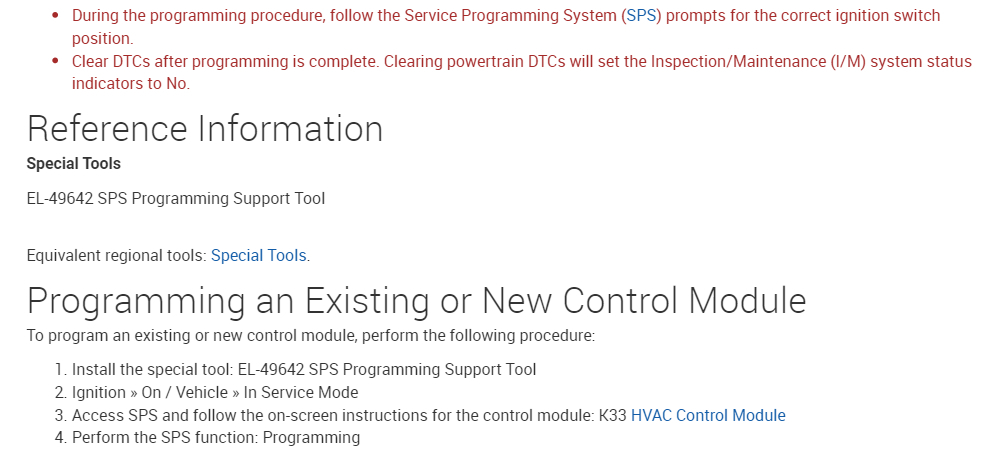

Anyway, the remote module for the HVAC is below the screen (center of the dash). See pic 1 below.

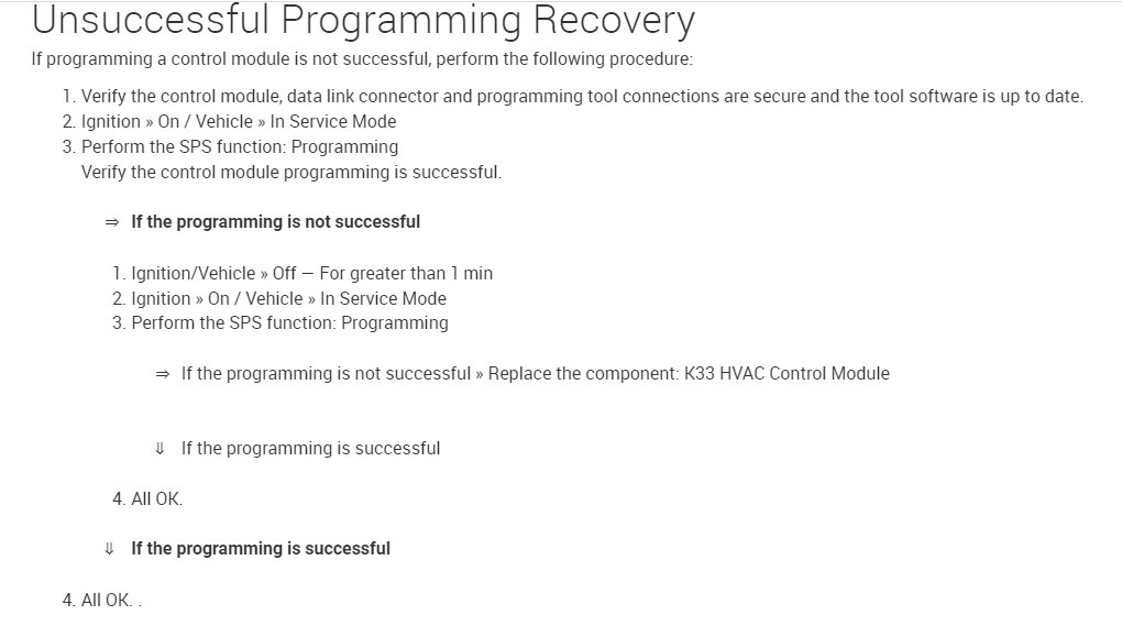

As far as testing, you need a bidirectional scan tool that can actuate the system and communicate with it.
I attached directions for reprogramming below. Chances are if this was done and the module was bad, it wouldn't complete the process.

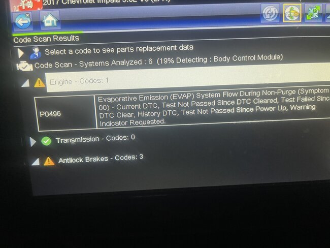

I attached the wiring schematic related to the Onstar. See pic 6.
Let me know if this is what you needed.
