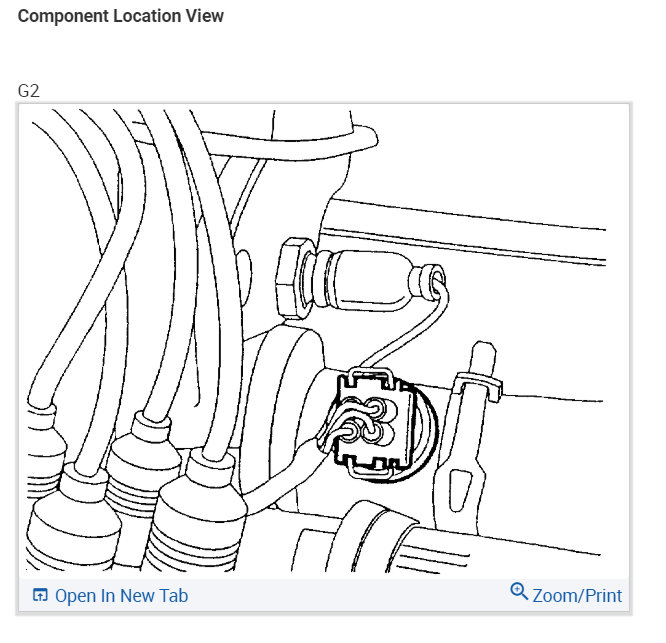

My car shuts off and acts like it is out of fuel. Replaced fuel pump/fuel filter/fuel pressure regulator. Runs until about 2:30- 3:00 pm then shuts off. I turn the key on and off it starts runs about a block and a half then shuts off. Anybody have any ideas? I do live in Las Vegas, NV. Could the heat have anything to do with it? 96 degrees today, Thank you

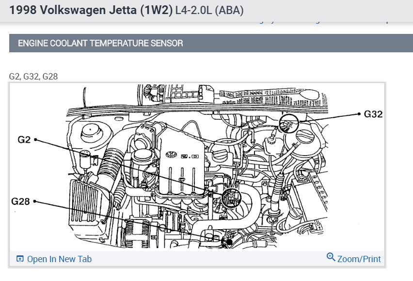

I have seen engine coolant temperature sensors short out when hot. Can you disconnect the sensor and then run the car to see if anything changes? Here is the location. Check out the diagrams (below). Please let us know what happens.
Thursday, June 20th, 2019 AT 12:11 PM
TWOBUC
Changed out coolant temperature sensor no difference, acts like fuel pump loses prime going to pull and check hoses and see if any leaks. Going to do fuel pressure check. Have a bad vibration when running at all times, I am thinking maybe not enough fuel. Thank you for taking time to help Ken.
