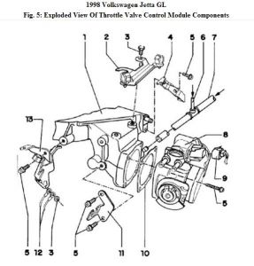

When engine is unable to idle at cold start, it could be due to a faulty Engine Coolant Temperature sensor.
When idling speed is low arfter warming up, insufficient air is getting past the throttle valve. The throttle valve could be clogged resulting iin insufficient air getting past. Spray some carb cleaner into the throttle valve and use a rag to scrub it clean.
https://www.2carpros.com/forum/automotive_pictures/192750_ThrottleValve98Jetta01_1.jpg
https://www.2carpros.com/forum/automotive_pictures/192750_ThrottleValve98Jetta02_1.jpg
