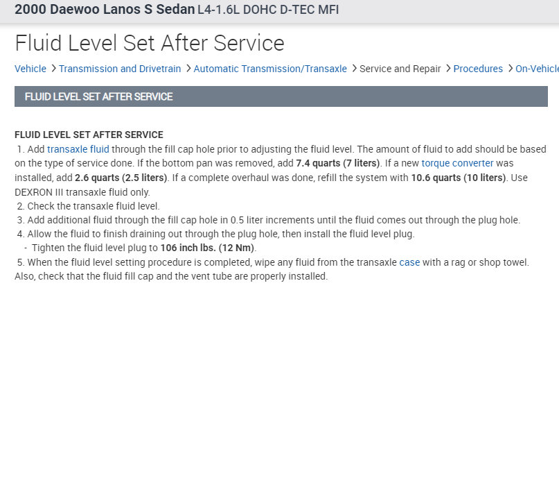

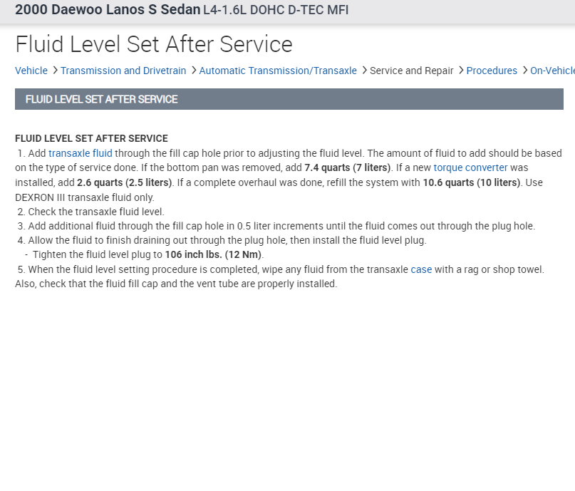

Where is the trans fliuld dipstick located
Wednesday, March 18th, 2009 AT 1:32 PM
SQM
  • 6,383 POSTS
This vehicle does not have a transmission fluid dipstick.
There are two plugs on the side of the transmission. One for to fill and check other to drain the fluid. This will require accessing from under the vehicle.
In order to check or fill/check the transmission fluid, remove the plug that is located higher. The transmission fluid level should be just below the plug opening.
