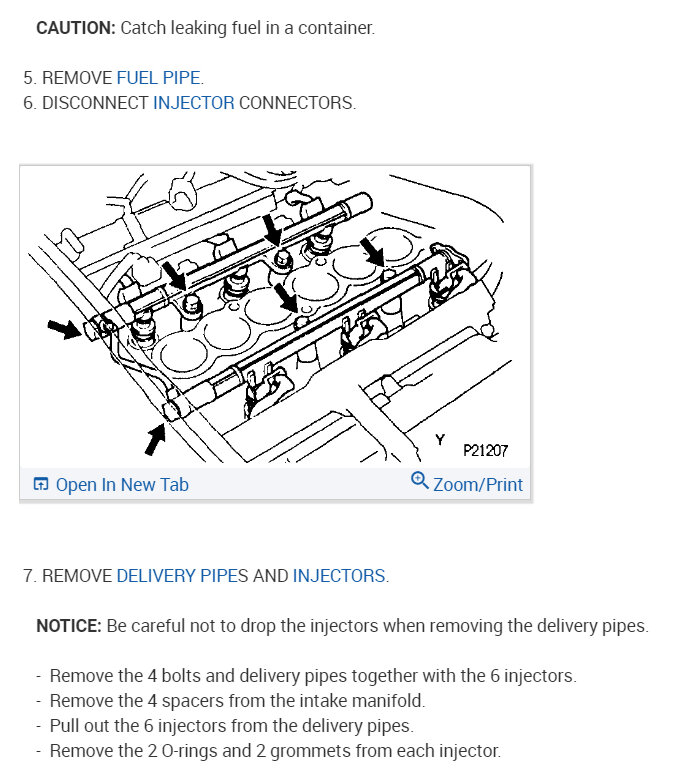

I just changed the plug and coil, but it is still driving like crap and showing that cylinder 6 is misfiring.

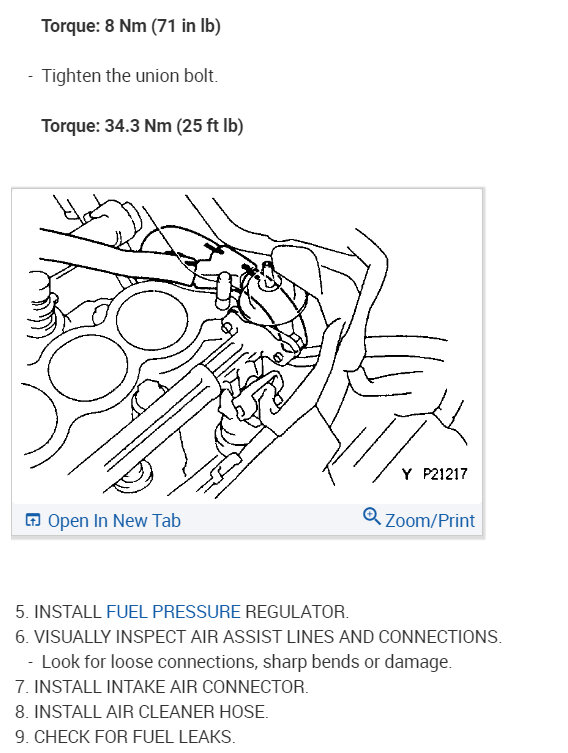

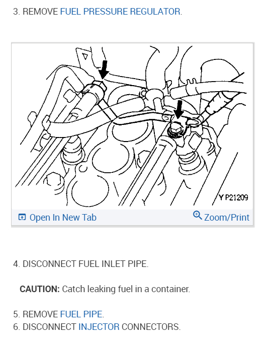

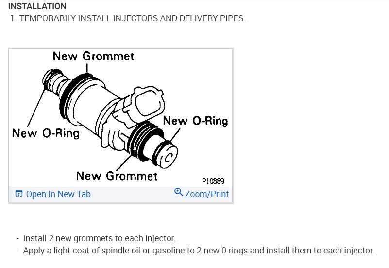

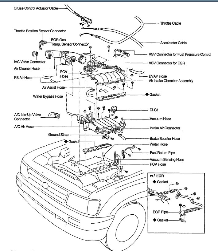

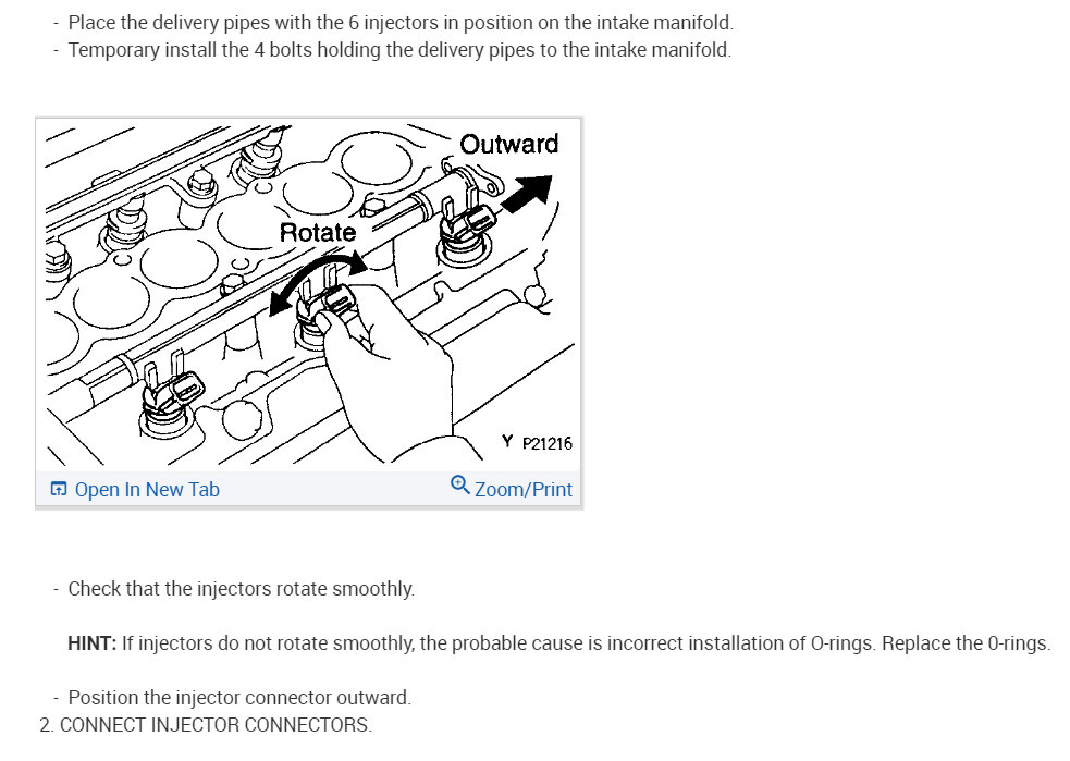

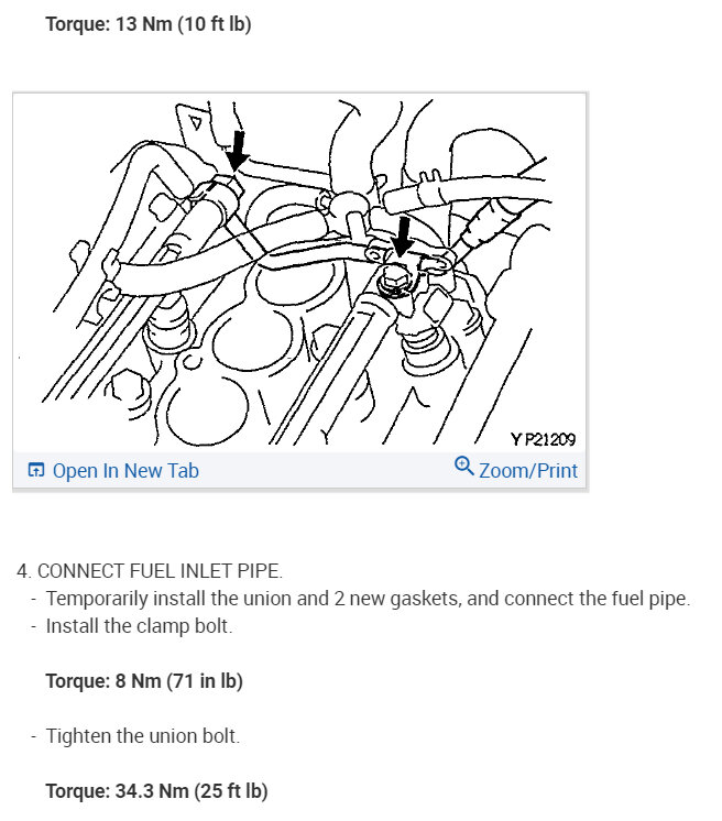

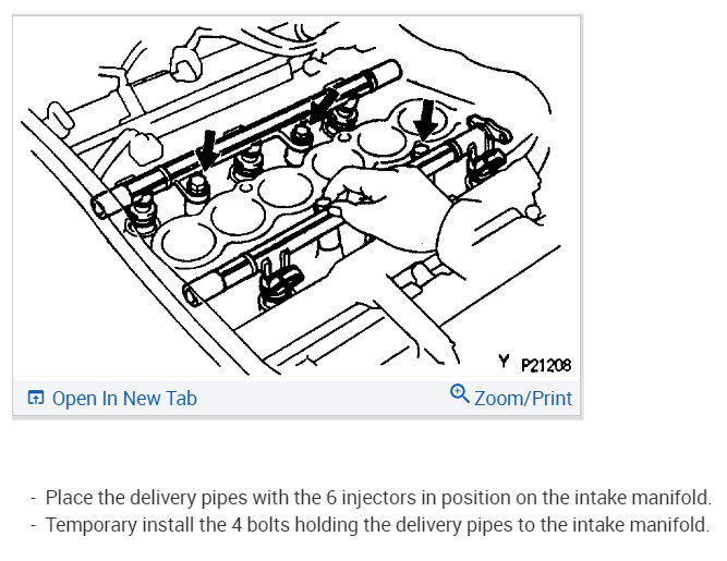

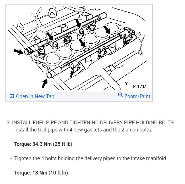

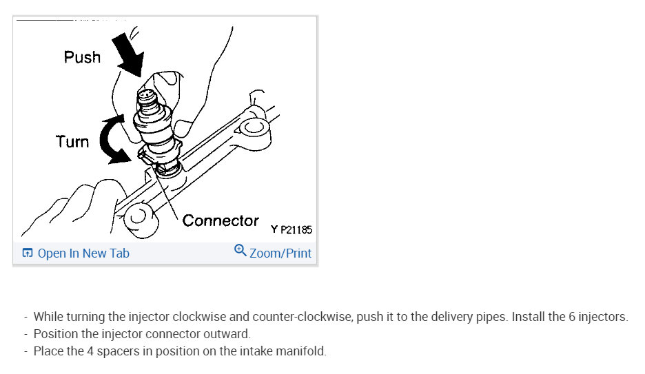

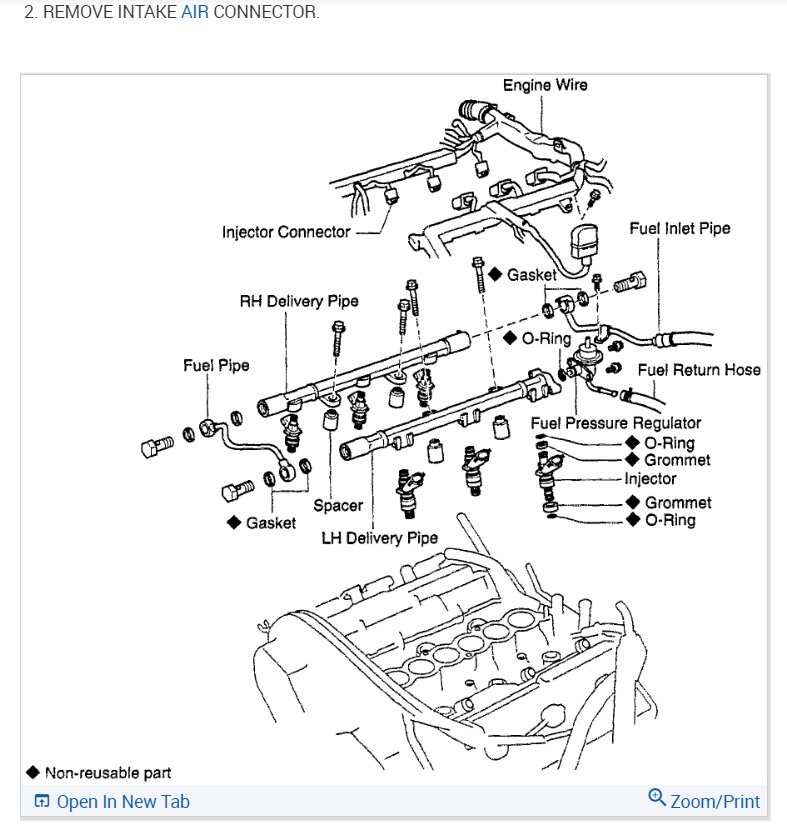

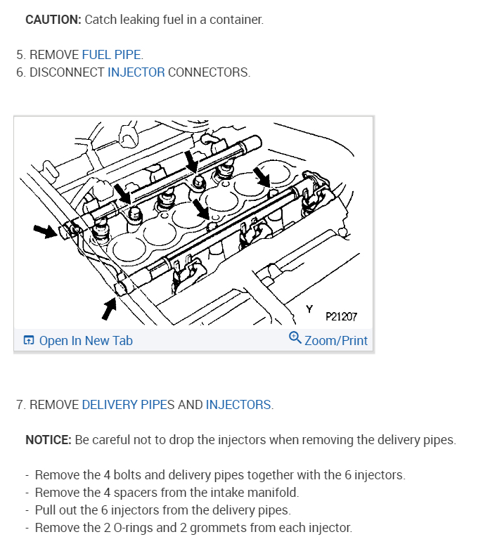

This is probably because of the fuel injector that is clogged, or you have low compression in that cylinder.
Here are two guides to help us figure it out and fix the problem:
and
Here is how to change the fuel injector out. Check out the images (below). Let us know what happens and please upload pictures or videos of the problem so we can see what's going on.
