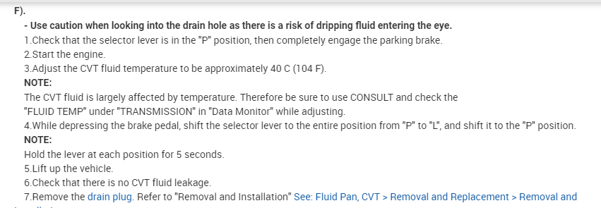

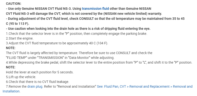

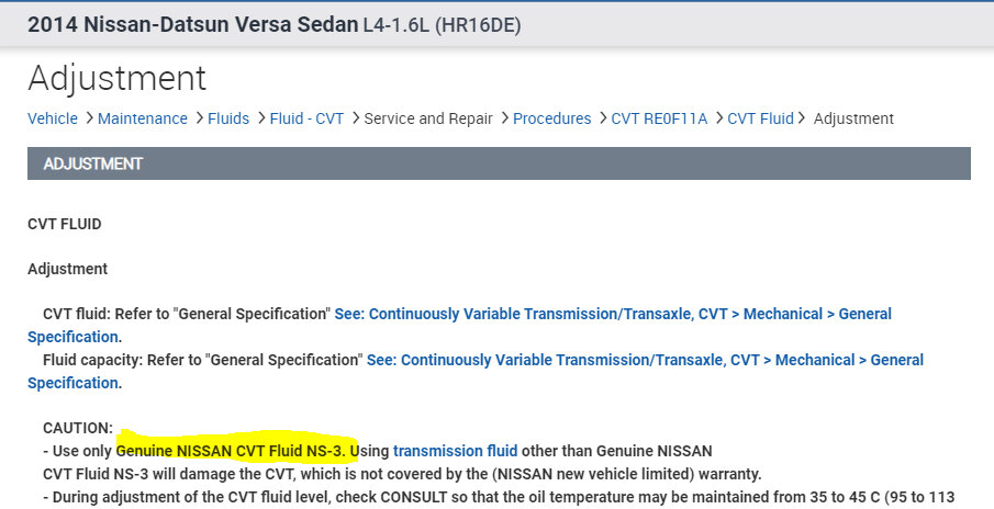

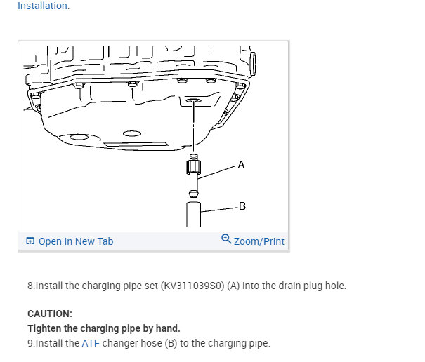

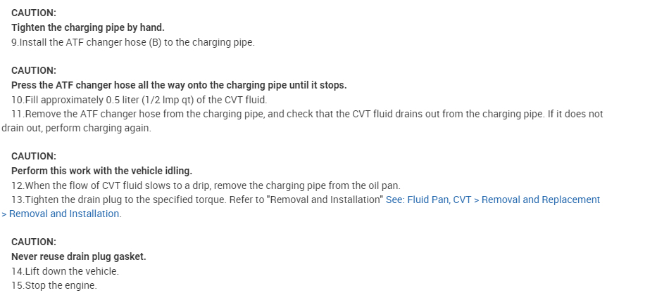

Have you checked to make sure the transmission fluid is full? This requires the engine/trans to be at a specific temperature and a special tool. They make nothing simple anymore. That is where I would recommend starting. If there is a shop near you that can check the fluid level, do that. I attached the directions below for testing. I'm not sure if you are comfortable performing it. If fluid needs added, you must use the correct fluid. See pics below.

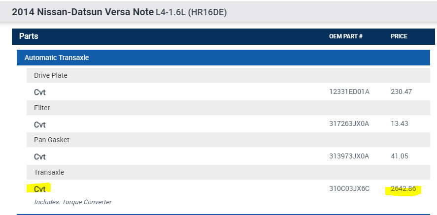

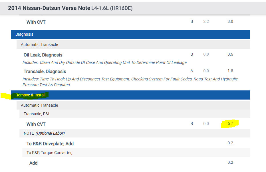

As far as a new transmission, the manufacturer's retail price is 2642.82. If you add labor and shop materials into that price, it will be well over $4,000.00. It calls for over 6 hours labor.

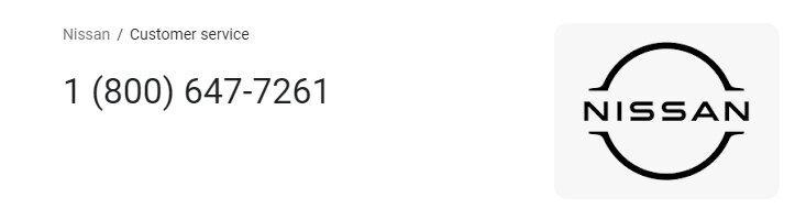

If this was my personal vehicle, I would be on the phone with Nissan demanding they repair it. There is no reason why a new transmission should fail after 35K miles or even the original 50K miles. There should be a customer assistance phone number in the rear of your owner's manual. Also, the last pic shows the phone number if you can't find it.

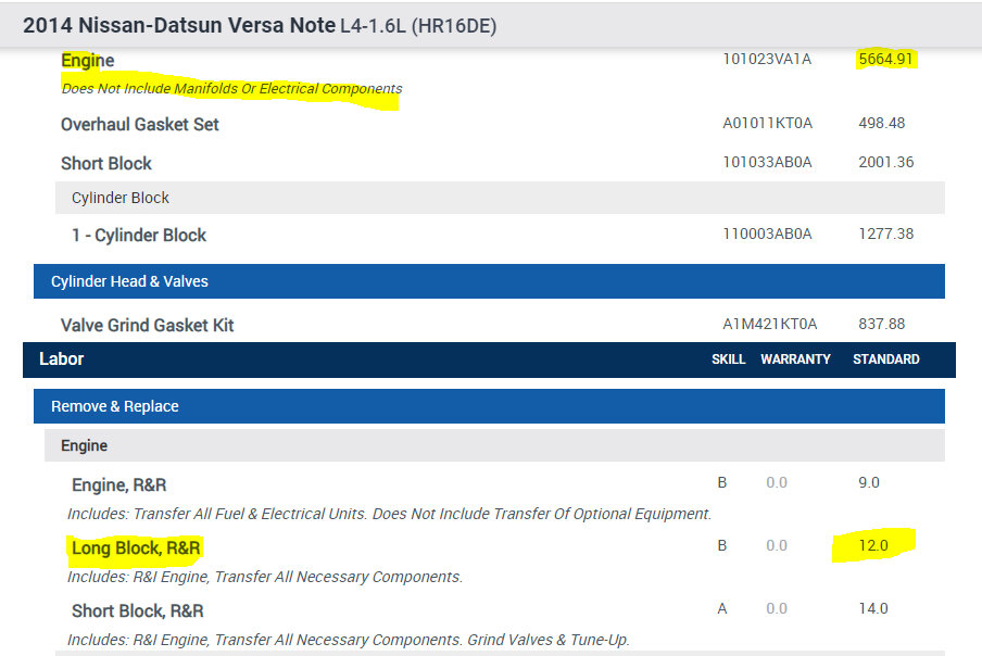

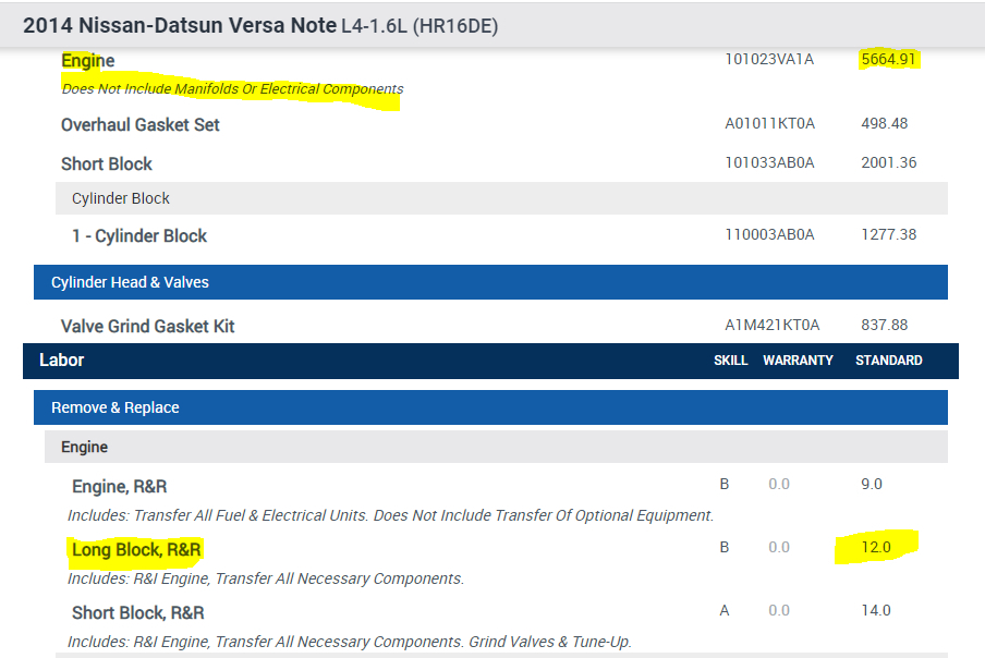

I attached the parts and labor prices below. Note that there are two ways of getting an engine. A short block will require the reuse of many of the engine components presently on your vehicle. For example, the intake manifold, exhaust manifold, fuel rail and injectors, and so on. A long block will come with many of the parts the other won't have.
If you look below, the engine cost is the retail price. The labor, in this case, would be considered for a long block, so there are 12 hours of labor. See pic 1.

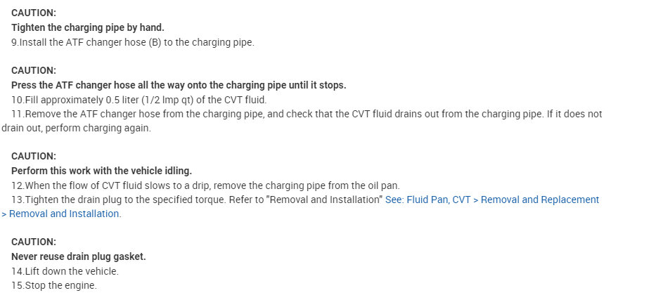

Pics 2 and 3 are related to the transmission. Keep in mind, these prices don't include things like shop supplies and disposal costs. However, the labor for one should be much less because they both come out at the same time, so they shouldn't charge fully for both labor rates.

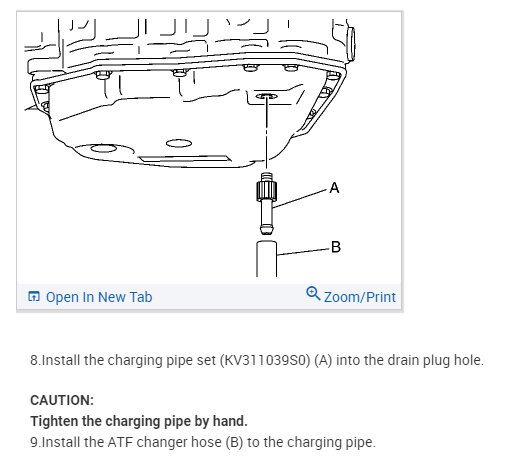

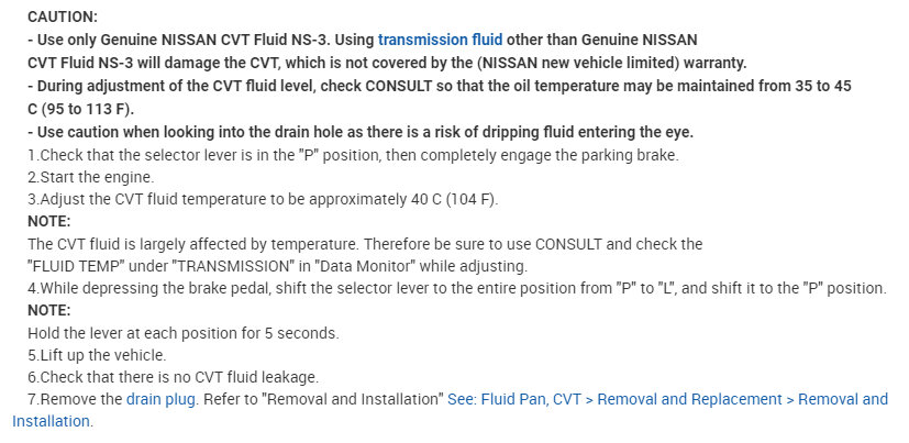

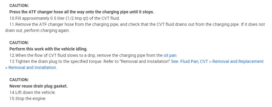

As far as the transmission level check, it requires what is called a charging pipe to check the level. This pipe is installed at the drain plug at the bottom of the transmission pan.
With the charge pipe installed, you need to add approx 1/2 qt of CVT fluid, start the engine, and allow it to reach a specific temp. Then, you remove the rubber supply hose to see if the fluid drains. If it doesn't, you need to add fluid. If it trickles out, it's good. They make nothing easy anymore.

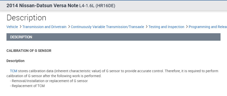

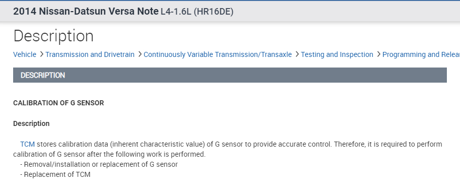

Also, you may want to have the G sensor recalibrated just to see if it makes a difference. See last pic below.

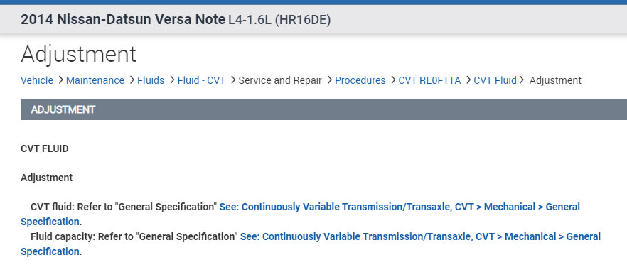

I attached the directions below. Let me know if you have questions.
