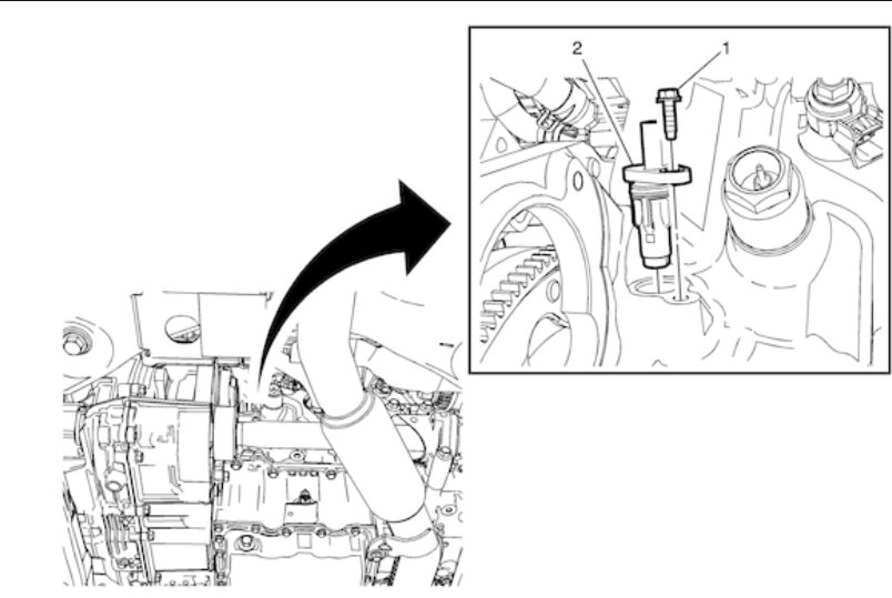

Crankshaft Position Sensor location
PAULJCOLE1980
  • 2013 CHEVROLET MALIBU
  • 2.5L
  • 4 CYL
  • 2WD
  • 135,000 MILES

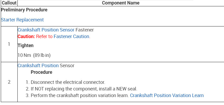

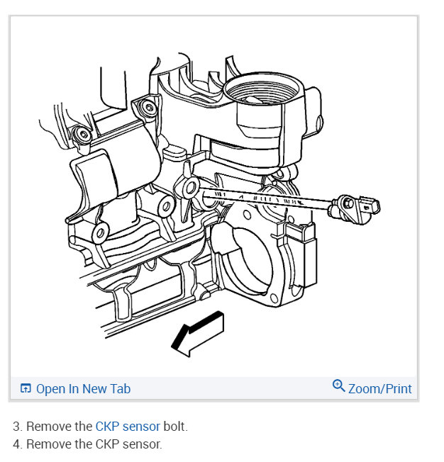

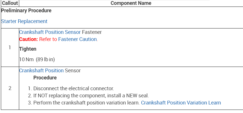

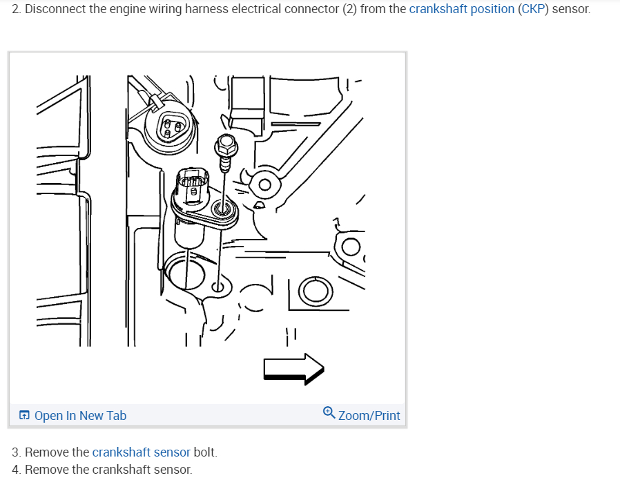

I'd just like to find the easiest way to get to the crankshaft position sensor. I think I need to remove the starter but a diagram would be helpful. Is it possible to remove the throttle body and access it from above?
Wednesday, January 27th, 2021 AT 11:03 AM (Merged)
DANNY L
  • 5,648 POSTS
Hello, I'm Danny.

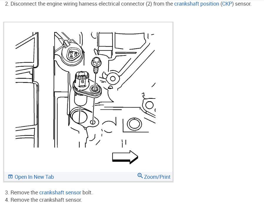

Yes, you have to remove the starter motor to have better access. Here is a tutorial showing what is involved for a crankshaft position sensor:
I've attached picture replacement steps below for your car. Hope this helps and thanks for using 2CarPros.

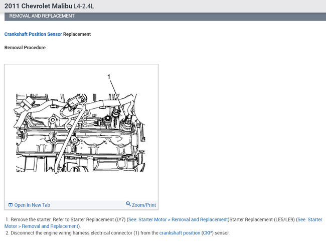

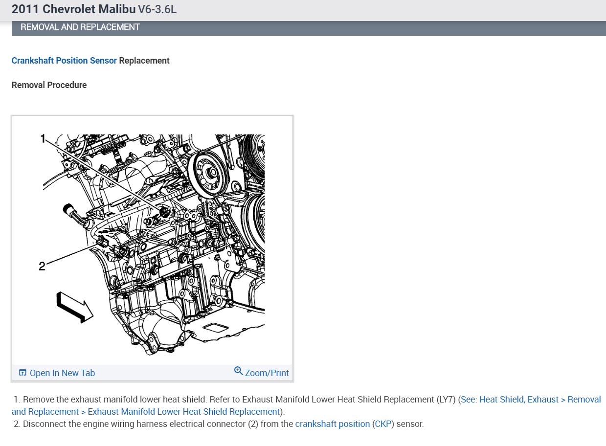

Hi, my question is how to test crankshaft position sensor with a multimeter and where is it?
SATURNTECH9
  • 30,869 POSTS
You just measure the resistance across the terminals on the sensor with it unplugged. Typically you would see around 800-1200 ohms Whey they fail they wont read a resistance value they will read as a open.

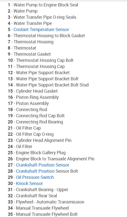

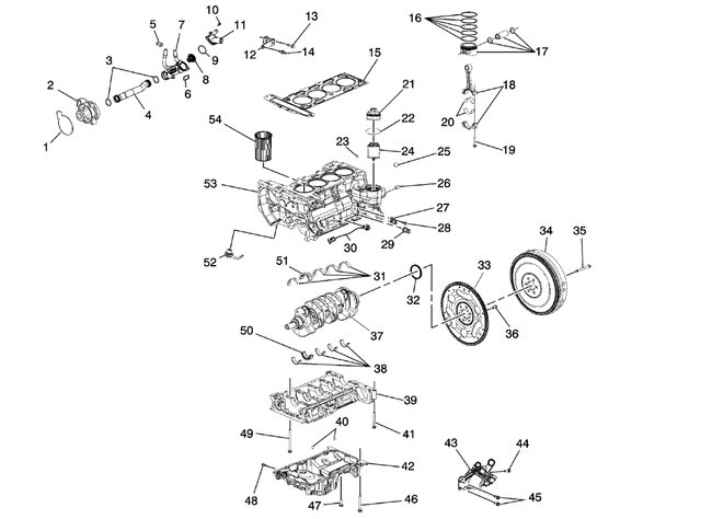

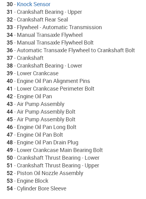

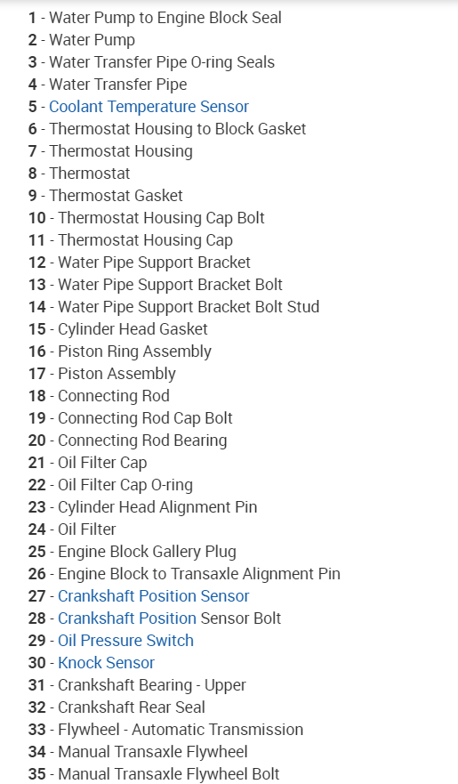

Here is the location of the crankshaft sensor and instructions on how to replace it in the diagrams below. I found both engines.

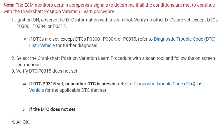

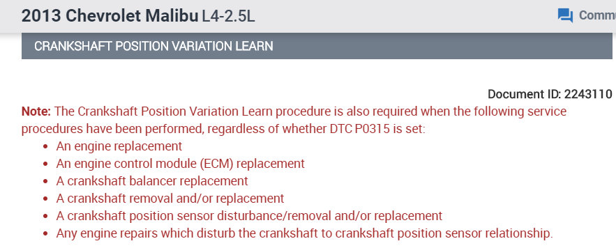

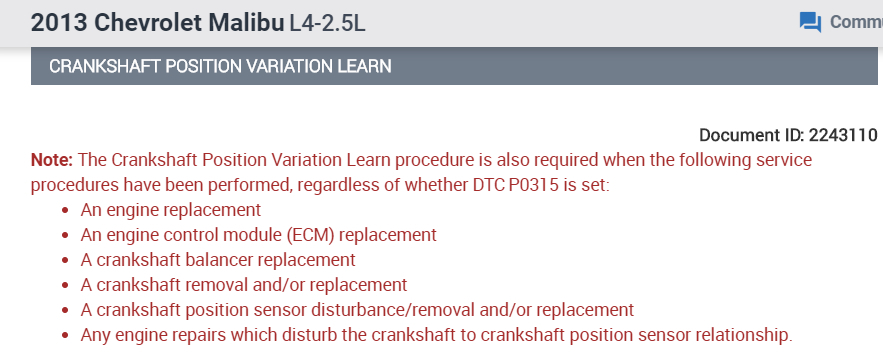

Crankshaft Position System Variation Learn
Note: The crankshaft position (CKP) system variation learn procedure is required when the following service procedures have been performed, regardless of whether DTC P0315 is set:
* Engine replacement
* Engine control module (ECM) replacement
* Crankshaft damper replacement
* Crankshaft replacement
* CKP sensor replacement
* Any engine repairs which disturb the crankshaft to CKP sensor relationship
Note: The scan tool monitors certain component signals to determine if all the conditions are met to continue with the CKP system variation learn procedure. The scan tool only displays the condition that inhibits the procedure. The scan tool monitors the following components:
* CKP sensor activity-If there is a CKP sensor condition, refer to the applicable DTC that set.
* Camshaft position (CMP) signal activity-If there is a CMP signal condition, refer to the applicable DTC that set.
* Engine coolant temperature (ECT)-If the engine coolant temperature is not warm enough, idle the engine until the engine coolant temperature reaches the correct temperature.
1. Install a scan tool.
2. Monitor the ECM for DTCs with a scan tool. If other DTCs are set, except DTC P0315, refer to Diagnostic Trouble Code (DTC) List - Vehicle (See: A L L Diagnostic Trouble Codes ( DTC ) > Diagnostic Trouble Code Descriptions > Diagnostic Trouble Code (DTC) List - Vehicle) for the applicable DTC that set.
3. With a scan tool, select the CKP system variation learn procedure and perform the following:
1. Observe the fuel cut-off for the applicable engine.
2. Block the drive wheels.
3. Set the parking brake.
4. Place the vehicle's transmission in Park or Neutral.
5. Turn the air conditioning (A/C) OFF.
6. Cycle the ignition from OFF to ON.
7. Apply and hold the brake pedal for the duration of the procedure.
8. Start and idle the engine.
9. Accelerate to wide open throttle (WOT). The engine should not accelerate beyond the calibrated fuel cut-off RPM value noted in step 3.1. Release the throttle immediately if the value is exceeded.
Note: While the learn procedure is in progress, release the throttle immediately when the engine starts to decelerate. The engine control is returned to the operator and the engine responds to throttle position after the learn procedure is complete.
10. Release the throttle when fuel cut-off occurs.
4. The scan tool displays Learn Status: Learned this Ignition. If the scan tool indicates that DTC P0315 ran and passed, the CKP variation learn procedure is complete. If the scan tool indicates DTC P0315 failed or did not run, refer to DTC P0315 (See: A L L Diagnostic Trouble Codes ( DTC ) > P Code Charts > Powertrain Management). If any other DTCs set, refer to Diagnostic Trouble Code (DTC) List - Vehicle (See: A L L Diagnostic Trouble Codes ( DTC ) > Diagnostic Trouble Code Descriptions > Diagnostic Trouble Code (DTC) List - Vehicle) for the applicable DTC that set.
5. Turn OFF the ignition for 30 seconds after the learn procedure is completed successfully.
