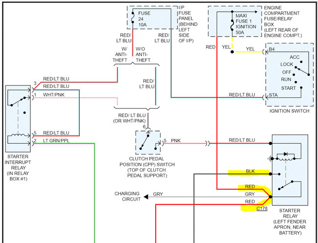

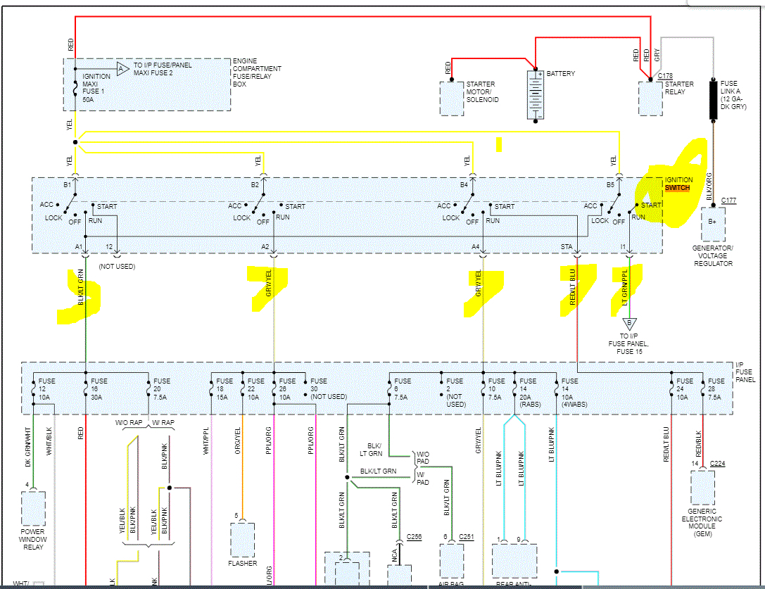

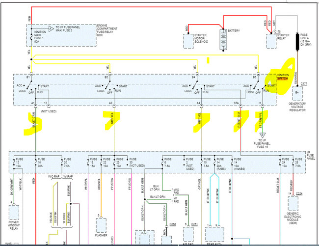

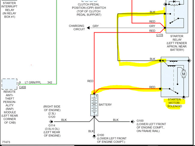

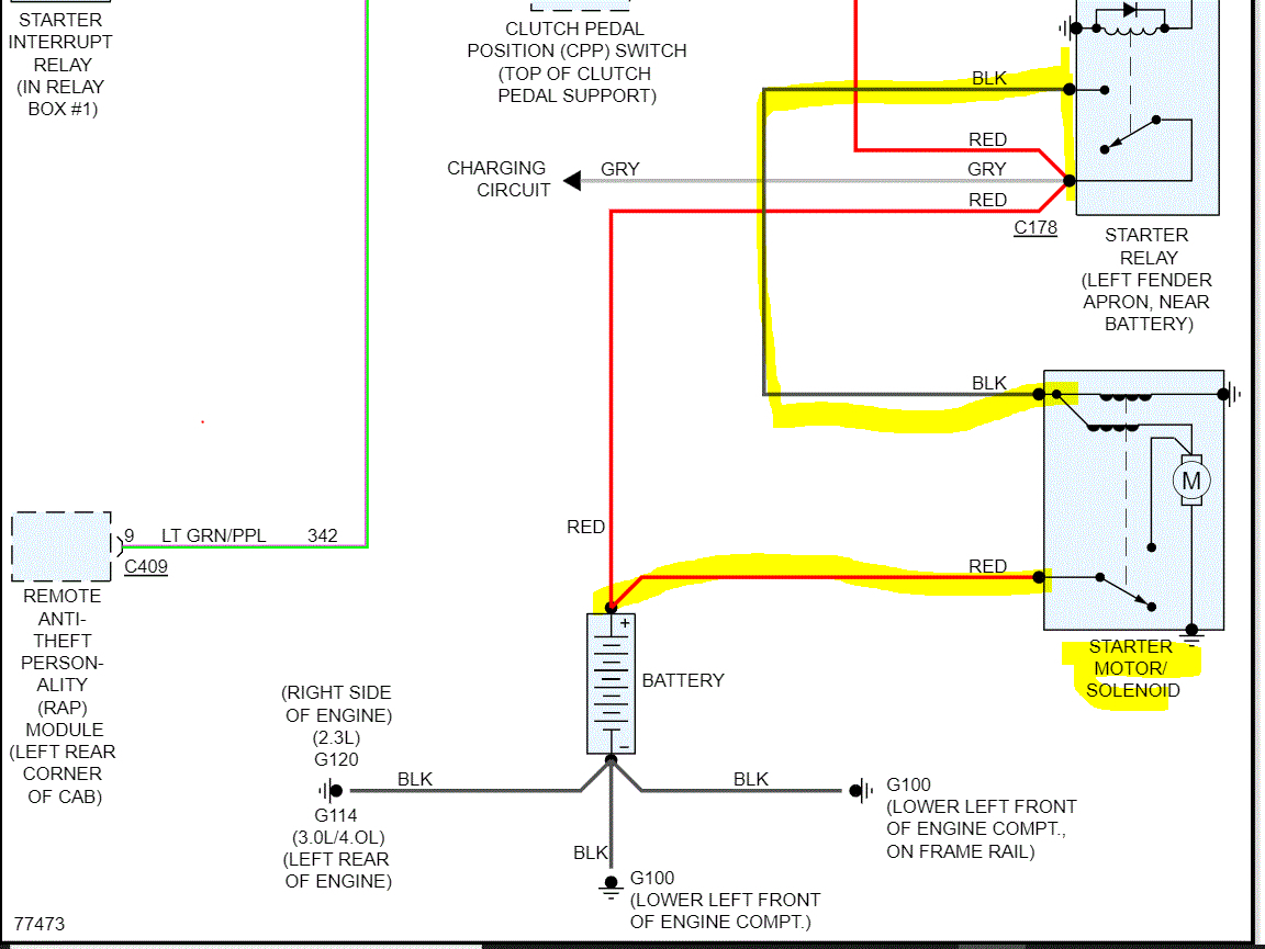

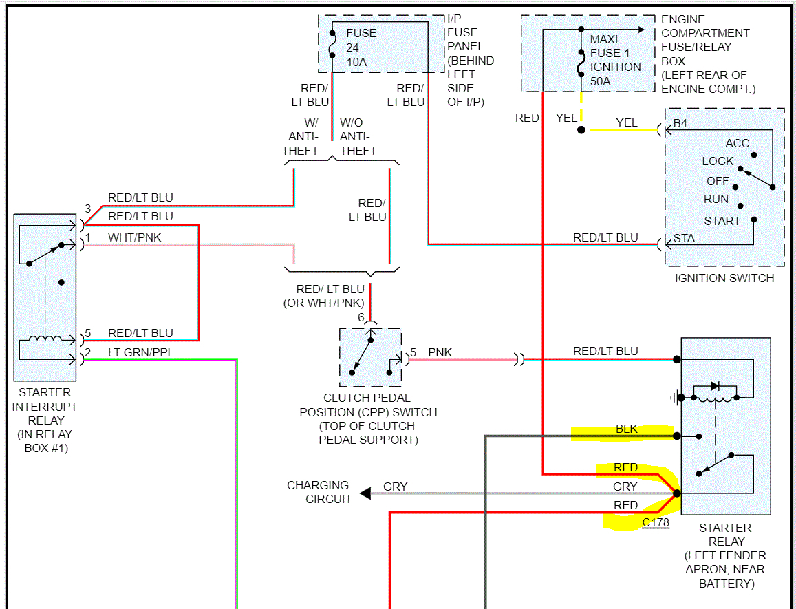

If you have no spark, getting it to crank won't change the no start condition. To show you how to engage the starter, I attached the wiring schematic below. At the solenoid, there will be a red wire straight from the battery. It will have 12v at all times. There is a black wire that goes to the starter. That is the trigger wire. If those two wires are crossed, the starter will engage. Keep in mind, this is bypassing the clutch starter switch, so make sure it is in neutral.
If there is no spark, I have a couple of questions for you. You said you wired a starter button. Please explain. Also, if you are able to make it crank, does the tachometer move at all when it is cranking indicating there is an RPM signal?
Let me know as much as you can. You may simply have a faulty crankshaft position sensor. Take a look through this link:
Again, let me know if there is an RPM signal, how the "switch" was wired, and anything you can think of.
See pics below. Note: I cut the schematic in half to make it readable. I did overlap the two halves so you can follow from one to the next.

I didn't wire in a starter switch. I pulled loose the original OEM starter switch that the cylinder is normally linked to. It slides to start the truck. I just tested it and all the wires get powered up when the switch is in run mode, except the black wire.

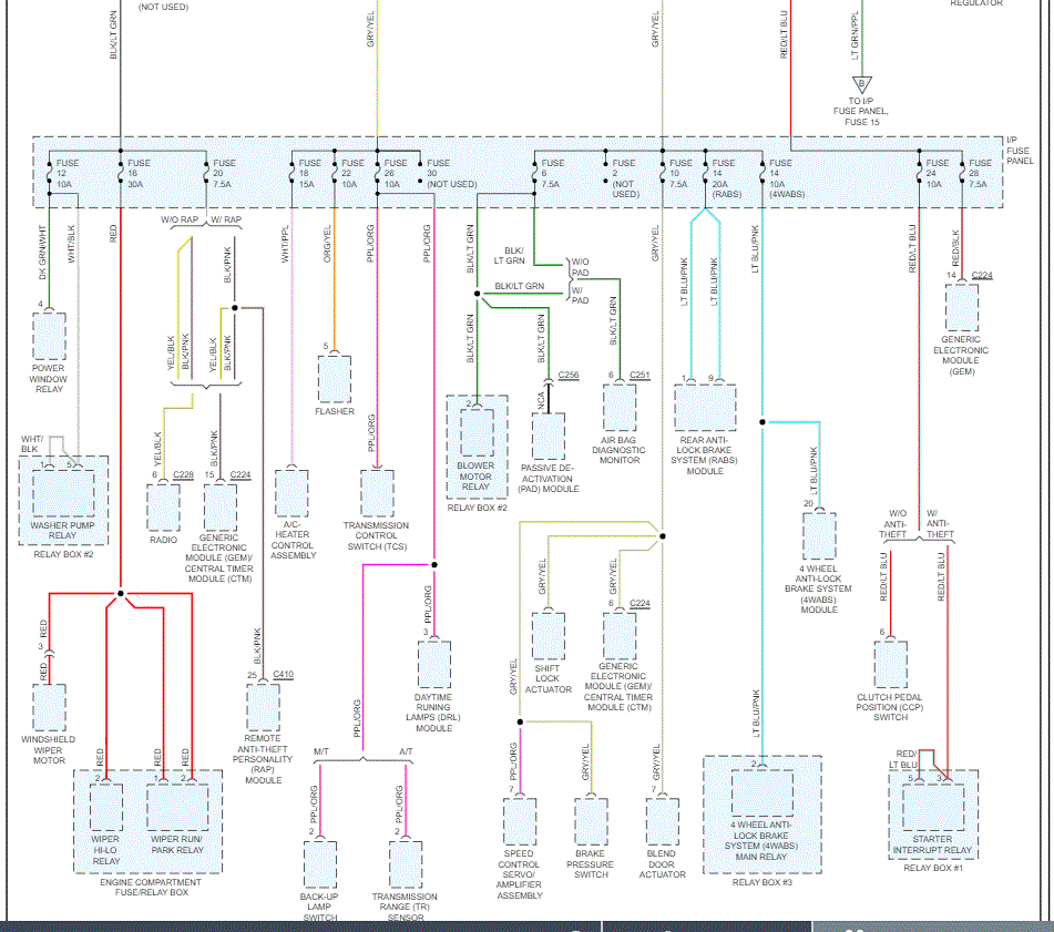

  • 110,192 POSTS

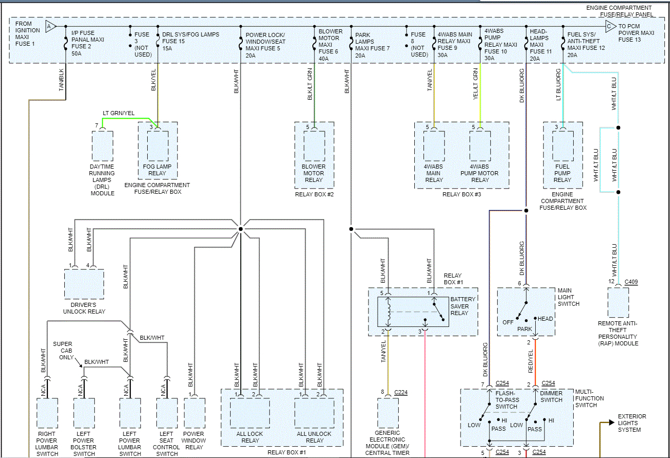

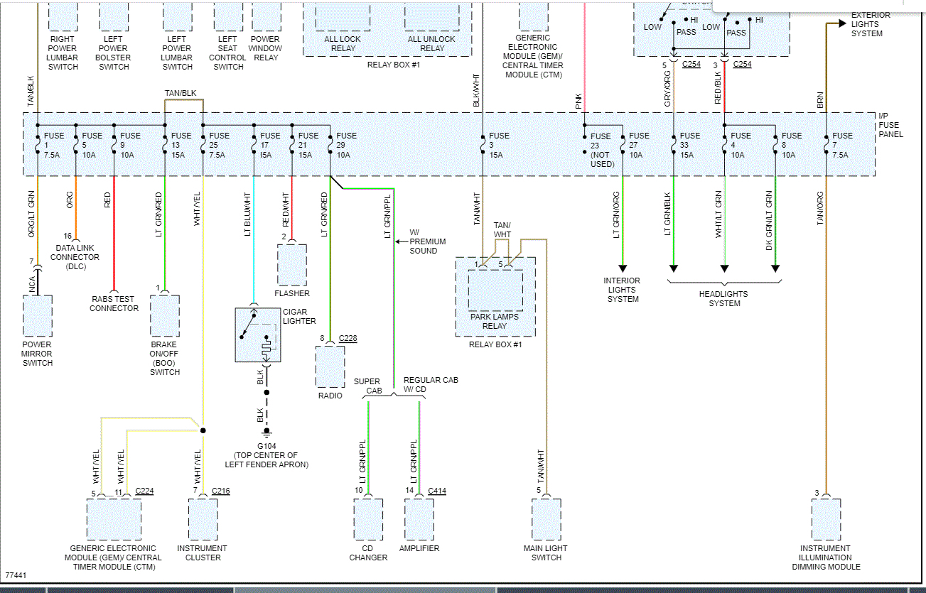

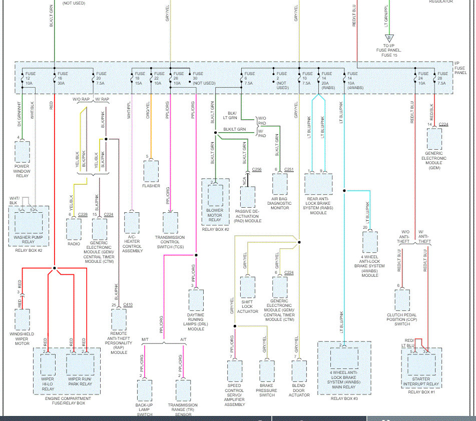

Without a scanner to check for an RPM signal or a tachometer, it makes it difficult to test the crankshaft position sensor. However, if you have power to the coils when cranking, I have a feeling that is what is bad.
I attached the wiring schematic for the power distribution circuits. I highlighted the ignition switch, but I am not seeing all the wires you referred to.
Take a look through this and see if it helps. Also, if you want the powertrain management schematics, let me know.
Take care and let me know your thoughts.
See pics below. Note: The schematics were three pages long. I cut each in half to make them readable for you. I did overlap them so you can follow them.

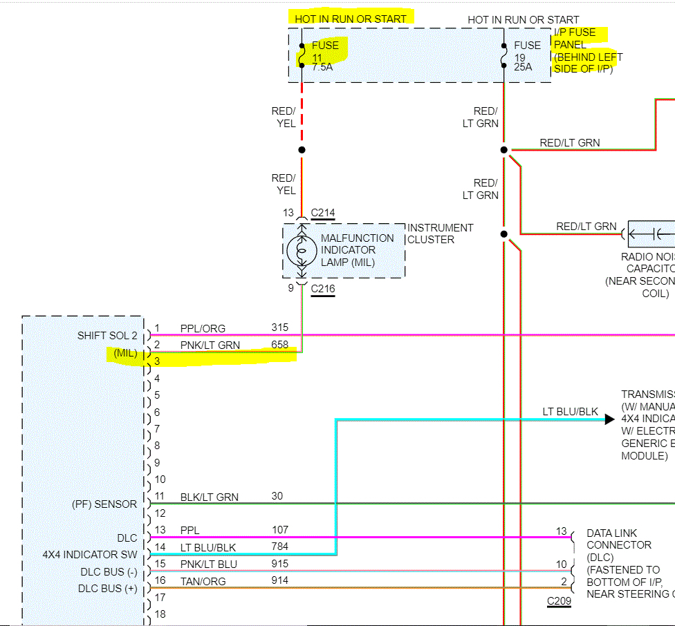

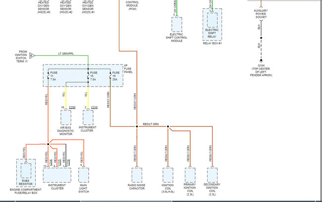

When I turn the key to the on or run position the check engine light should come on for a second or two and then remain off. Mine never comes on. I read this indicates that the PCU computer isn't getting power. But all the other icons light up briefly. Also, wouldn't the check engine light, light up briefly if it was just the CPS?
Thursday, February 10th, 2022 AT 2:21 PM
  • 110,192 POSTS

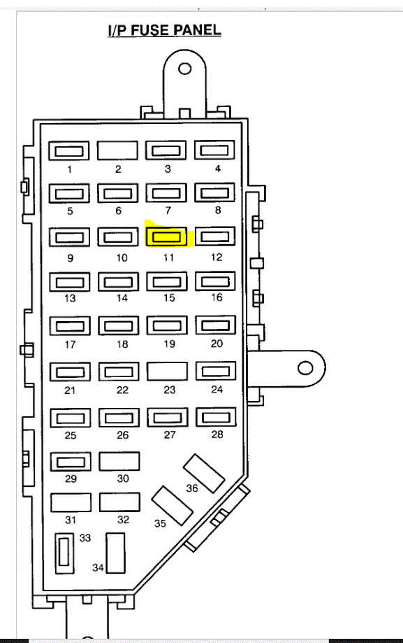

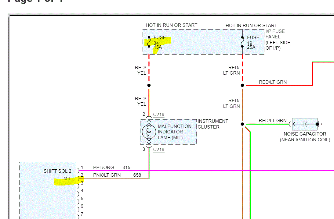

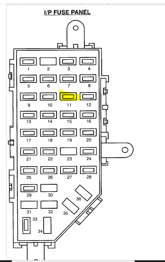

The CEL (or MIL according to Ford), gets power from fuse 11 in the fuse box under the dash. The PCM provides a ground path to illuminate the light. Pin 2 on the PCM connector, which will be a pink wire with a light green tracer, can be checked to determine if there is a ground being provided. Also, check fuse 11. In addition to checking the fuse, make sure there is power to it. Here is a link you may find helpful.
I attached a pic from the schematic showing the wiring related to the light. Note: No light doesn't mean the PCM is bad. If it doesn't provide the ground path needed, then suspect the PCM is bad.
Let me know what you find.

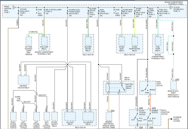

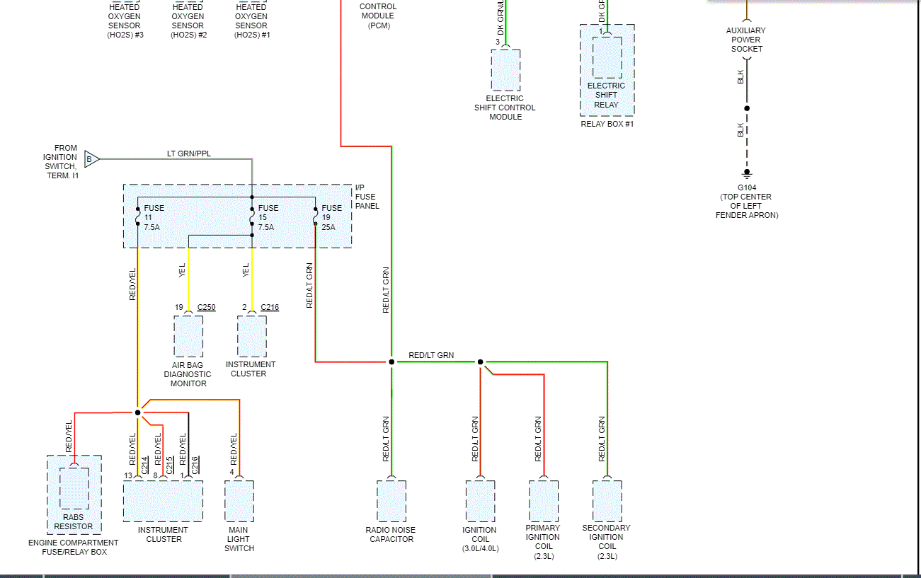

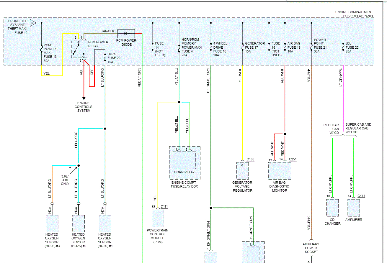

  • 110,192 POSTS

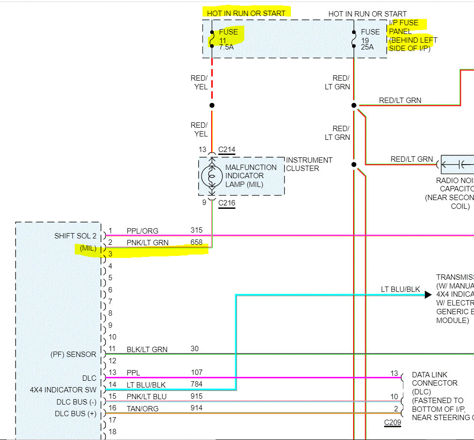

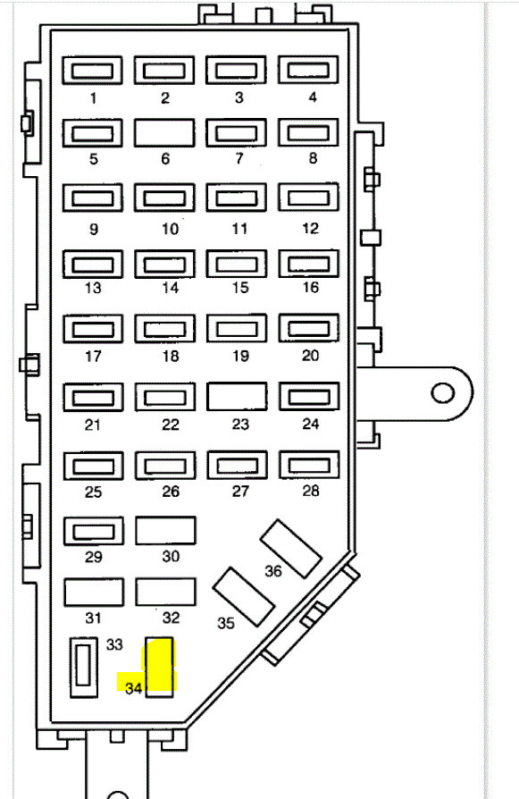

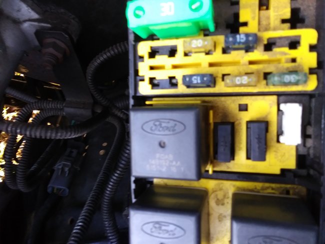

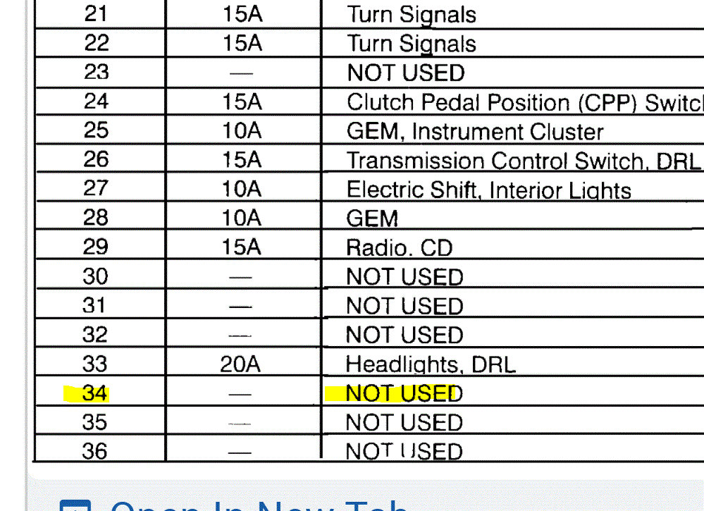

I went back a year since it was an early production vehicle. The wiring color is the same, the pin is the same, but the fuse number is different. In 1995, fuse 34 is what powered the light. (See pic 1)
So, I went and looked up the fuse box to confirm, found fuse 34, and found fuse 34 was not used. Ugh! See pics 2 and 3)
Check to see if there is fuse 34 in the box.

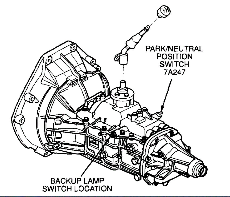

Progress? The reverse lights remain off when the stick is in reverse, and the key is on run. I'm trying to hunt down the DTR sensor. If it's 1 of the plugs coming from the transmission, then they are all in tight but the one towards the front is very dirty and needs cleaning. I haven't had much success identifying it but I read that it can be jumped with a wire. This could be the problem.
Sunday, February 13th, 2022 AT 3:05 PM
  • 110,192 POSTS
I attached a pic below showing the transmission switches. Let me know which one you are referring to.
See pic below.
